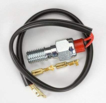

I used a Goodridge pressure switch on my custom setup. It seemed a lot easier than fabricating something mechanical. It just replaces the normal banjo bolt. Not sure, but they probably offer various sizes and such.

I see! How is the reliability on the pressure switch?
I didnt come over this pressure switch so Ive only looked at master cylinders with mechanical switch. Its brilliant!

I can't speak to the reliability of this exact switch but the same technology is used on our OEM rear brakes.
I'm using two of them. One front, one rear. They aren't as sensitive as the factory mechanical lever switch but that could easily be a variable with differing brake setups.
