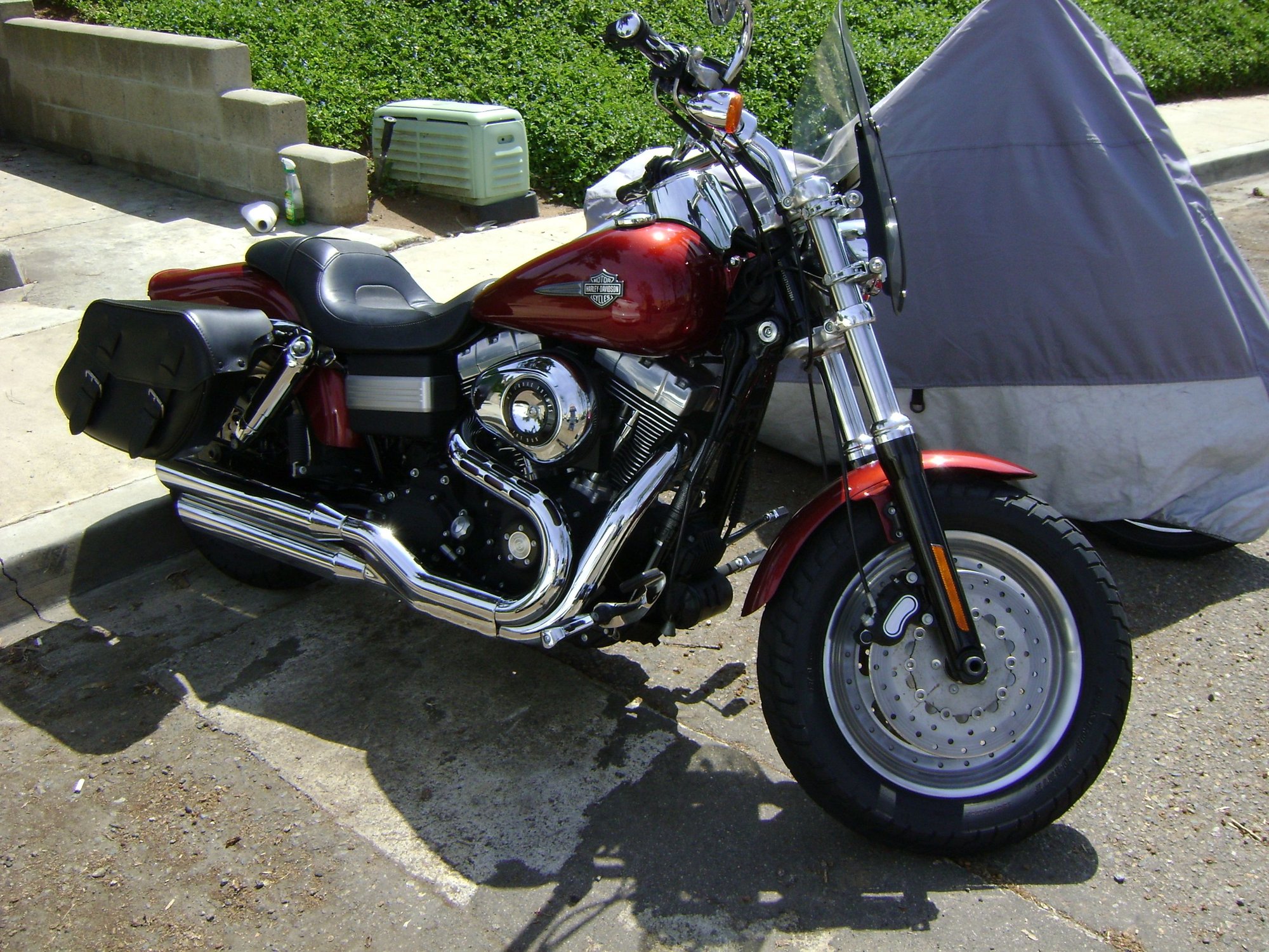

Had it for sale since it started vibrating. No interest. But this bike fits me like an old tennis shoe. Want to keep it.

So you didn't get rid of this one soon enough?
Who would want to get rid of this?
