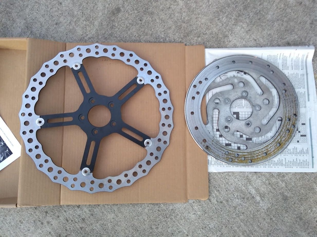

Finally had a sunny and warm(ish) day here, so took off work early to install the Arlen Ness Big Brake Kit on my '03 Superglide. Actually a pretty easy install - maybe an hour total. Only tricky bit was getting the caliper installed, since I couldn't get it to slide on the disc once the disk was installed, so loosened the disc bolts to get it to rock out, slipped the caliper on and then tightened the disc back down. The disc looks huge compared to the stocker. Put a pic below for comparison.
