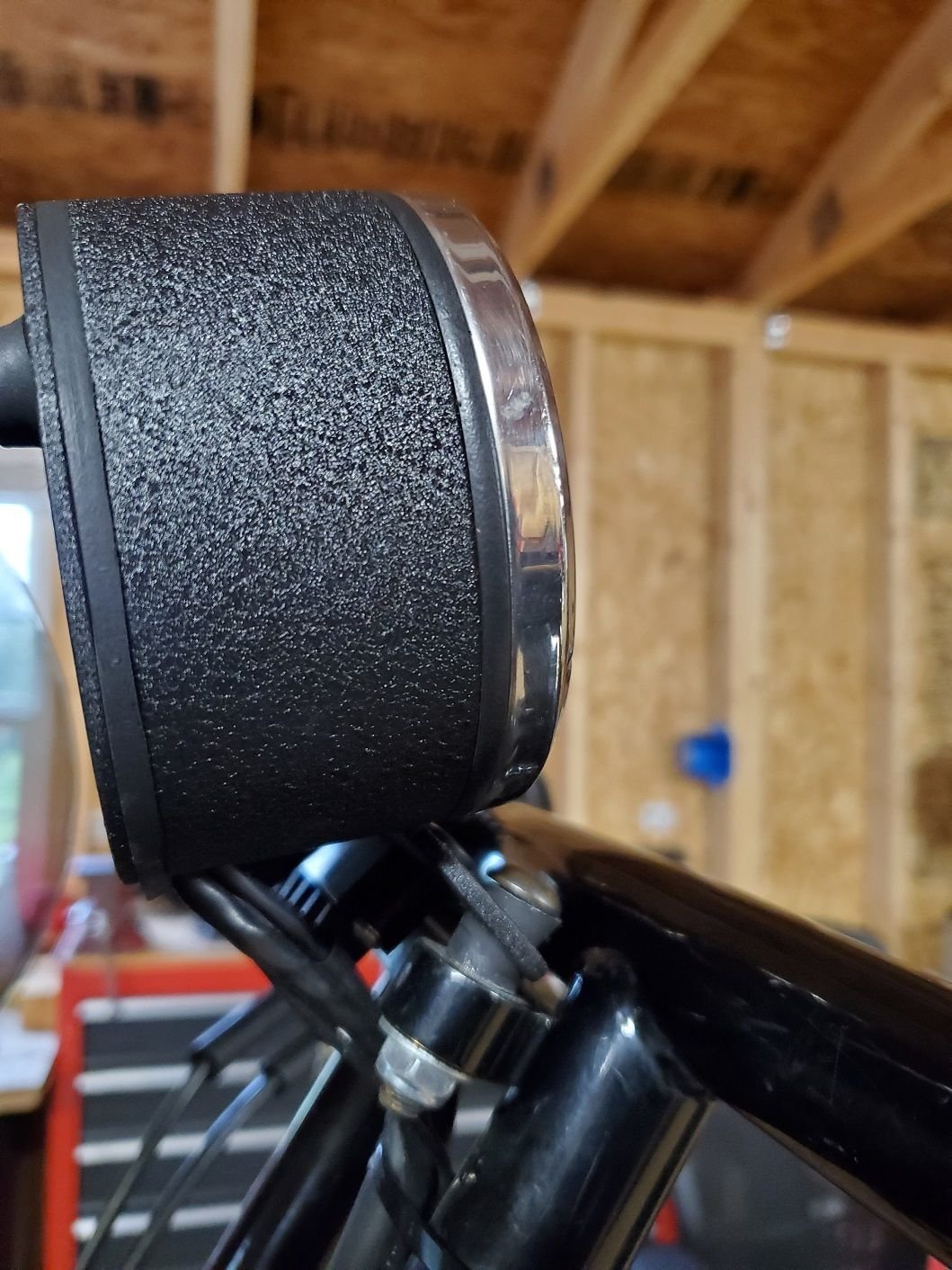

In order to get my tach and speedo standing at the correct angle I made a couple of angled spacers from some steel tubing.....It worked fine considering that I just marked it and used a hack saw to cut the angle.
