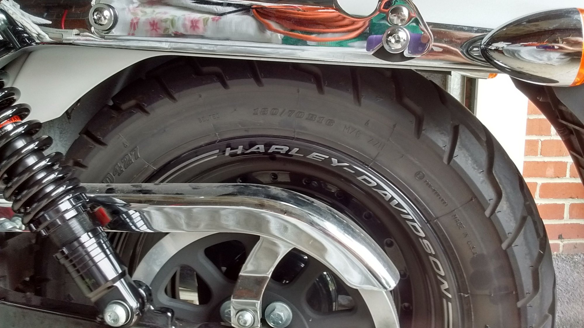

Default Picture of my new drag specialities adjustable shocks
New shocks mounted. I had a hard time deciding if chrome or black would look best. I went with the black.
Drag specialities.
Old Sep 2, 2019 | 10:28 AM
tnichols's Avatar
tnichols
Joined: Apr 2009
Posts: 96
From: London
Default Drag specialities adjustable shocks
Old Sep 2, 2019 | 10:35 AM
tnichols's Avatar
tnichols
Joined: Apr 2009
Posts: 96
From: London
Default Raised fender 1.5 inches
New look. You can see a lot more of the tire now with the longer shocks.
