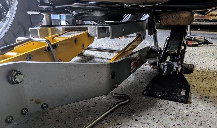

Okay, it's installed! But don't get too excited yet, it started raining yesterday afternoon before I was finished, and it hasn't stopped yet. Hopefully I can get out for a checkout ride tomorrow after work.
Install was straight forward, as one would expect for a motor mount swap. In my case, I went from a Predator to the new Kinetic Structures mount. Just to be clear, I've been very happy with the Predator for about three years now, but I do get a lot of engine vibes at certain engine speeds and I've been curious enough about these new mounts to warrant a try. Cornering stability is more important to me than complete engine isolation, so I'm a little skeptical about the lack of a stabilizer, but the manufacturer's explanation of using different spring rates for isolation in each direction makes sense to me. I made the install a little more involved than may be necessary, as I wanted to perform a proper vertical alignment after swapping the mount. Before getting started, I put the bike on the J&S lift and removed the seat and gas tank (for access to the top link). While in the air, I cracked everything loose on the Predator.
I also took a moment to loosen the jam nuts/bolts on my rear Sputhe stabilizer, thinking the engine may align more accurately without tension back there.
Before switching lifting methods, I also popped of the oil filter for full access to the motor mount area. Last year I switched to K&N filters, largely for the ease of install and removal. I recently changed oil and filter, so I didn't drain anything (other than the few drops lost from the filter). When I was done, I popped the same filter back on and checked level (one note for accuracy: 11/16 is not actually the right socket size, it's 17mm).
At this point I took the bike off the J&S stand, as it doesn't provide proper access to the bottom of the engine. I used my old Sears yellow jack with one height extender on the rear side, positioned under the very back of the frame. This held the bike securely vertically, and allowed a scissor jack to fit under the engine itself. You don't need to lift it enough to take the front wheel off the ground, just enough to keep the bike vertical.
Fortunately I found the upper mounting bracket on a shelf, which was removed when the Predator was installed. I watched the install video on the Kinetic Structures site first (https://www.kineticstructures.com/ha...ne-mount-video), then installed everything hand tight to evaluate the need for shims. The KS mount ships with two shims, I decided one seemed to position things properly.
The KS mount doesn't ship with hardware, so I did what I always do... Ordered a bunch of polished ARP stainless from Alloyboltz in Florida. It took some figuring to decide what goes where (hardware is included for all three mounts). Since the top link was already exposed, I swapped hardware up there too, but left the rear alone.
Annoyingly, the shouldered bolts which seem intended to hold the upper bracket to the engine cases are a little longer than needed, and hang out the bottom a bit. Maybe I'll cut them at some point, but they don't interfere with anything. I tried a pair of the shorter non-shouldered bolts, but they only just threaded and really seemed too short. Anyway, it's all installed now. Bolts are torqued, oil filter is back on, alignment is checked (still spot on from my last alignment), tank and seat are installed.
I started the bike on the lift (back on the J&S for alignment), and I can say that at idle the engine moves a lot less within the frame than it had, as is demonstrated in the comparison video on the KS website. I'm not yet sure whether this is a good sign or not though... I mean, if the mounts were completely solid the motor wouldn't move at all within the frame. But I don't think hands, butt or feet would be very happy... I know crusader1xxx had to mess with his a bit before it really felt good, but I'm pretty sure mine is now shimmed and aligned properly.
