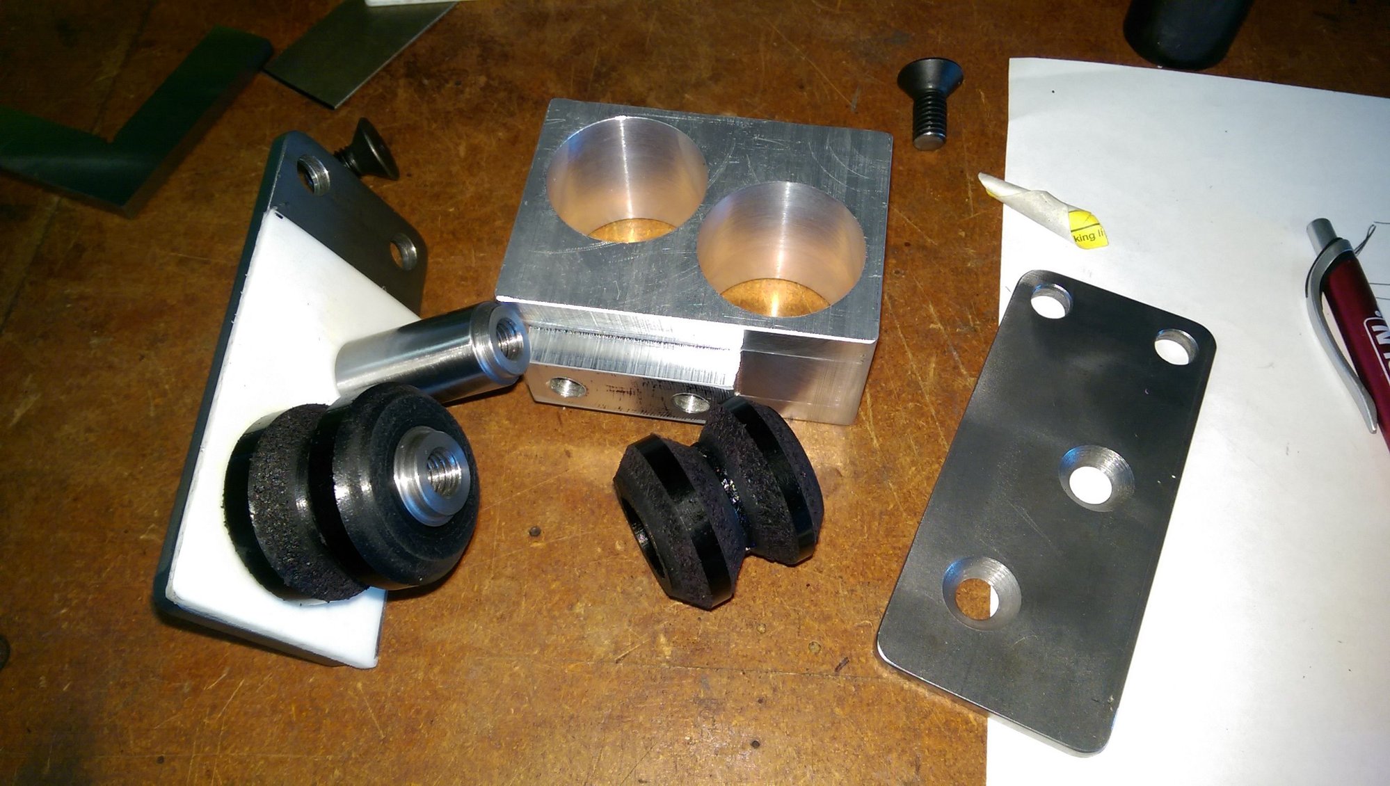

It wouldn't surprise me that the wire mesh system doesn't adequately address the side to side stiffness required of the front motor mount. Here is an idea to address side play. The mount itself does not do too well for vibe isolation tho.

Very interesting idea! Kinetic's claim that different spring rates are used got me wondering along similar lines (solid mounts laterally, rubber mounted vertically). But my idea was basically a stock-stye setup, but the side plates have radiused grooves that the center block rides in, with rubber above and below. Yours looks like it makes more sense, though!
