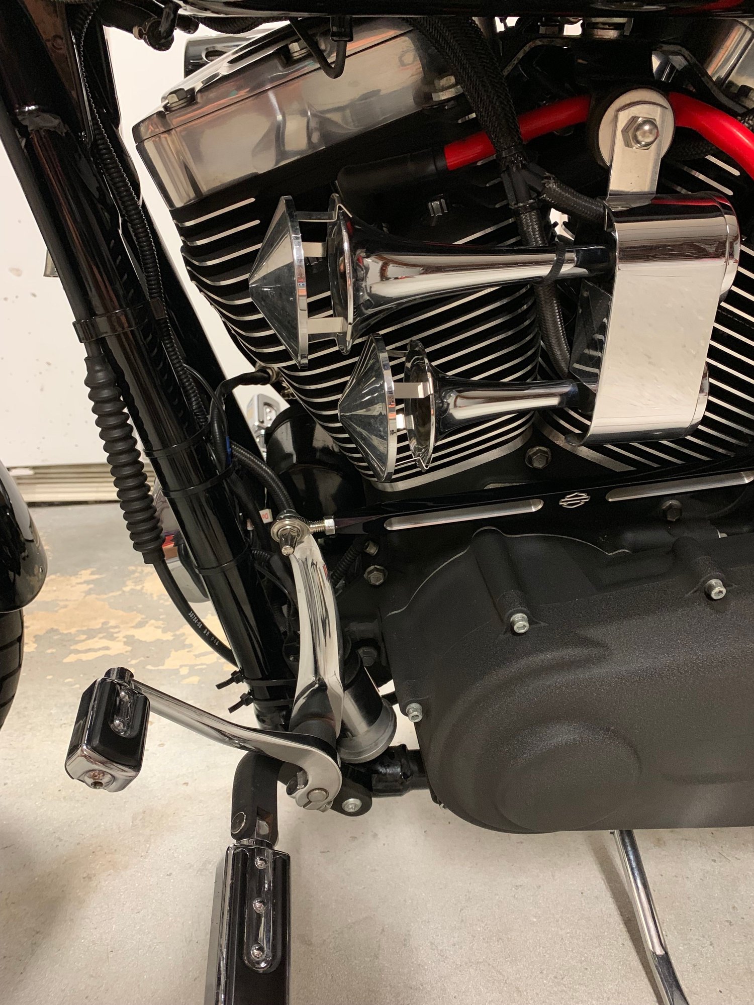

Hi. I had a quick question I was hoping someone could help me with.
After hitting some brutal roads here in Jersey, I noticed a knocking sound when going over bumps/pot holes. The noise started happening more and more. Before my ride home tonight, I started looking for something loose. I found something that was zipped tied to the frame by the oil filter. The zip ties were very loose and the part was very loose. I looked all over google but couldn't find too much information on the part.
Please see the pictures. I circled the part with red. The part looks like it has a mount of some sort, but can't figure out where it goes. Can anyone tell me what this is? Does it mount somewhere? Any help would be greatly appreciated.

So I took another couple of pics.
There are 2 wires coming off this thing. One looks to be grounded to the front motor mount on the bottom and the other goes into a braided wiring sheathing. The sheathing looks to go to the controls.
There really are no "add-ons" with the bike except the dual air horn (also shown in the picture). In that picture, you can see the part I am talking about behind the forward controls. Could the wire going in to the controls be for the horn?

Looks like the compressor for those air horns....

Bingo. Thank you !!! You are 100% on.
If anyone is interested, here is the link to what it is:
https://www.rivcoproducts.com/shop/h...vidson/ah-050/
I was able to re-ziptie it and it seems secure, for now.

Zip ties are probably not the best, I would look into some large worm gear style clamps...

Mount it to the frame with Adel clamps. Two clamps on the compressor and two on the frame. Bolt each pair together.
Where is the air line from the compressor to the horns?
