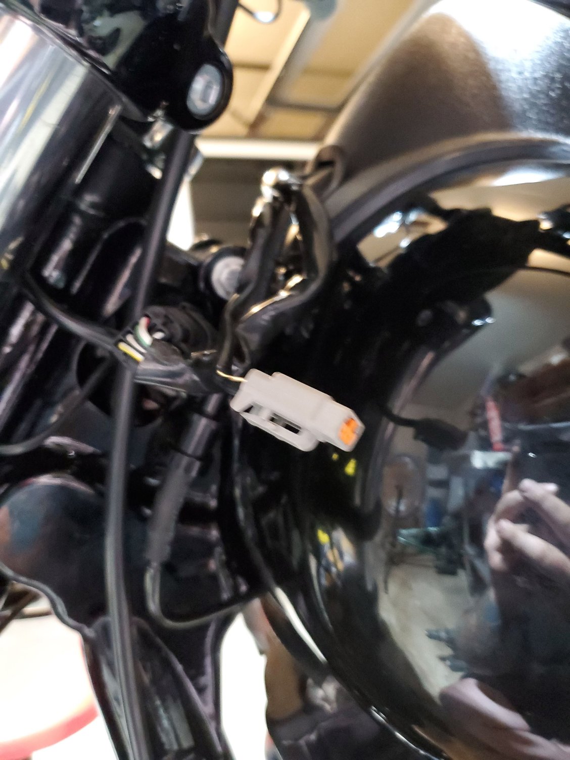

What is this connector for? It was stuffed in the frame from the tank when I pulled the plug. Everything seems to be working right but maybe I'm an idiot.
Pulled it all out and I actually have two seemingly extra connectors?

You have a fuel gauge on that bike? Mine has a similar 2-prong terminal for the fuel gauge.
My fuel gauge is lit but the needle isnt moving currently... Display reads 180mi left but my low fuel light is on ... My abs light just keeps blinking too

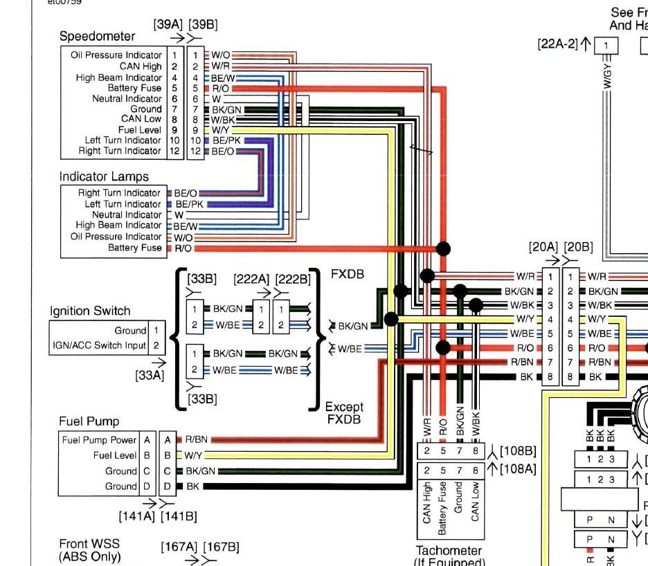

SO this branches off my speedo...It is a white/blue wire and a green/black wre...If im reading this right it is for my high beam indicator light but i still cant find anywhere it hooks up to the bike
