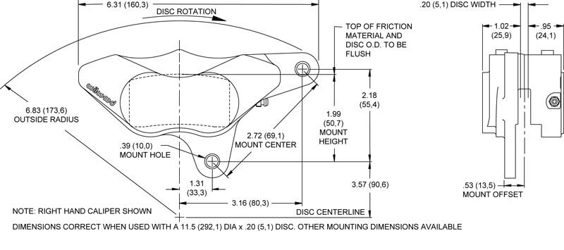

The Wilwood Front Caliper might work just fine on that NG. See the Wilwood Dwg below. It shows it being only .95" from inside of rotor to Inside/Back of Caliper body.
I have a NG fork/wheel set-up just like yours ... I grabbed a ~.983" wheel spacer to use as a gauge and was able to slide it down the inside of the rotor past the brake pad "Swept" area before interference with a spoke. So in theory it should work ...YMMV
Summit Racing usually has some of the best prices on those cals (looks like a Coupon on top of their page) ... You use the 84-99 # 120-7737 (Left) & 120-7736 (Right) with some (or no) suffix)
Wilwood Motorcycle Caliper Page
Summit Racing Wilwood Calipers 120-7737 & 120-7736
