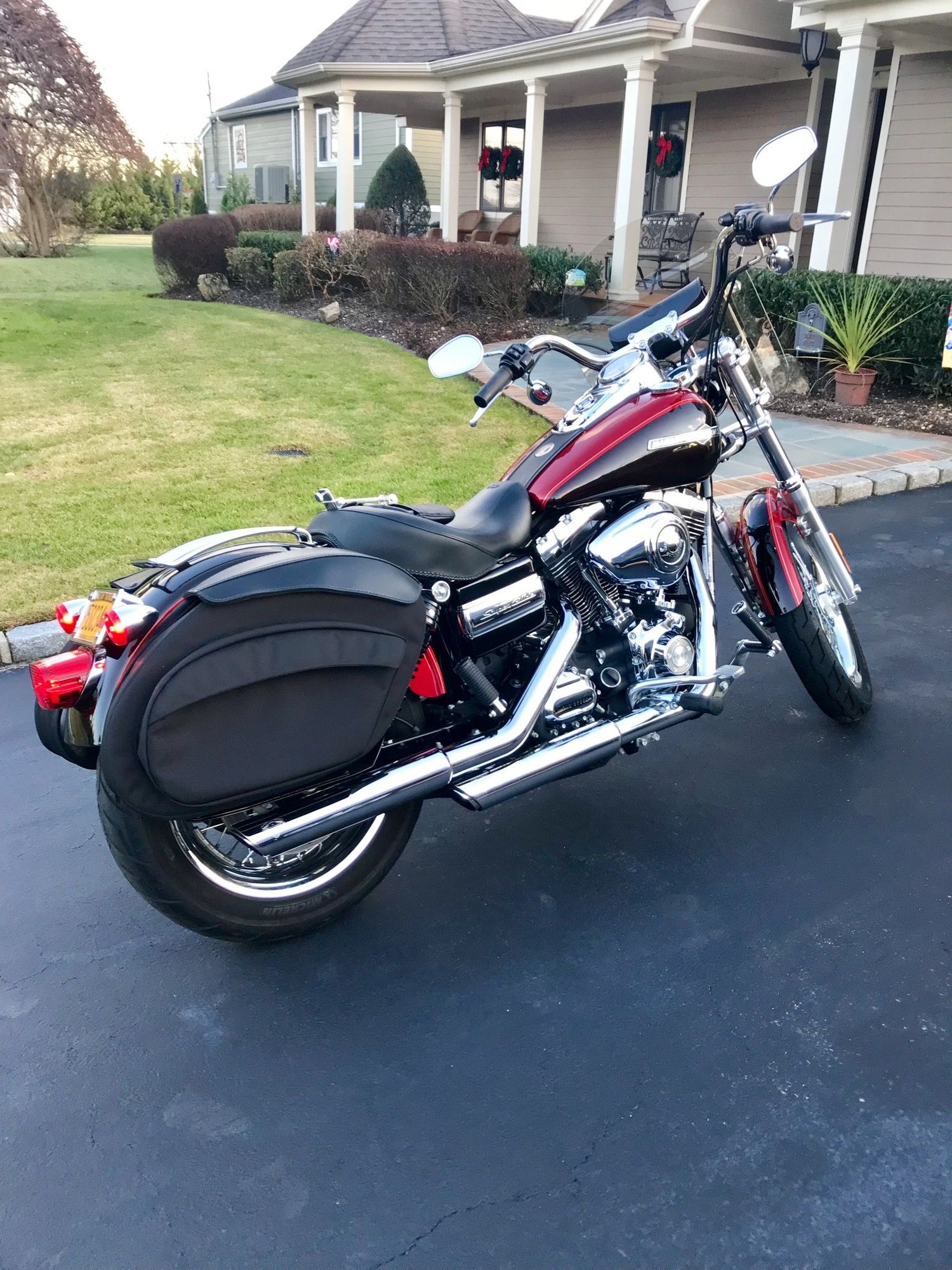

Originally Posted by Antonio *****
It’s not black. It doesn’t look “mean”. But, as good as it looks she rides even better.
It's as sharp as they come
My bike is Charcoal Pearl, I'm not sure if it has any human traits, it can be modestly quick I guess though, not by itself of course.
