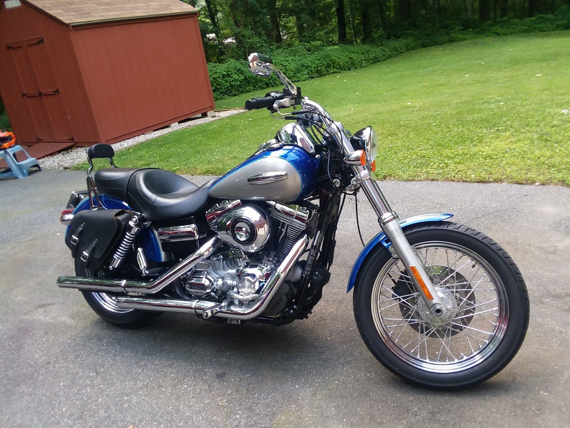

Yup, my 09 has oxygen sensors. Fuel Moto seems to get good reviews for products and customer service. I'm kind of a fan of the club bike look myself. My bike has a lot of Chrome from the factory and to tell you the truth, if I had bought a new bike I would have gotten black on black as I'm not much of a chromo-sexual kind of guy but I got such a good deal on it, I couldn't pass it up. I think a chrome 2 into 1 would work along with a Big Sucker with just the Chrome cover. what do you think....pic of bike as she is today below.

Sharp looking bike TheHeretic, minus the a/c cover, detracts from the motor IMmostHO
Originally Posted by Antonio *****
No doubt a 2 into 1 adds performance. But, staggered duals on a Dyna is the way the Lord meant them to look.
Staggereds is a great look on them, especially on a built motor!

Suede I could not agree with you more, the stock AC is Ugly's even uglier step sister!!!
