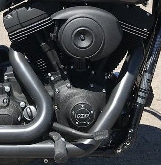

Totally agree!
Wild Guess as to your "Camp"

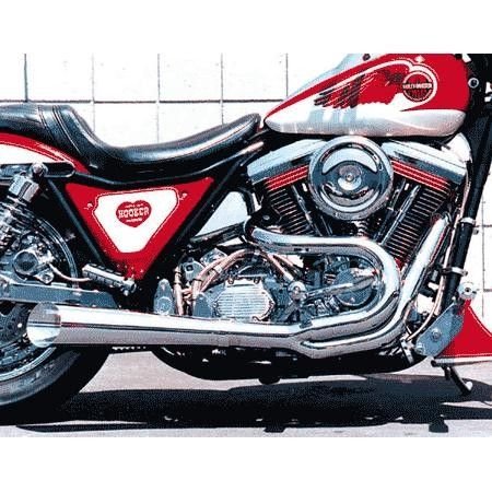

I picked up this Hooker years ago ( Huh ) and want to try it on something ... The "Right" bike

ooohh. I love that pipe. The older SE 2-1 had a similar look and I always thought both of them screamed hot rod. That slash cut end does it for me.

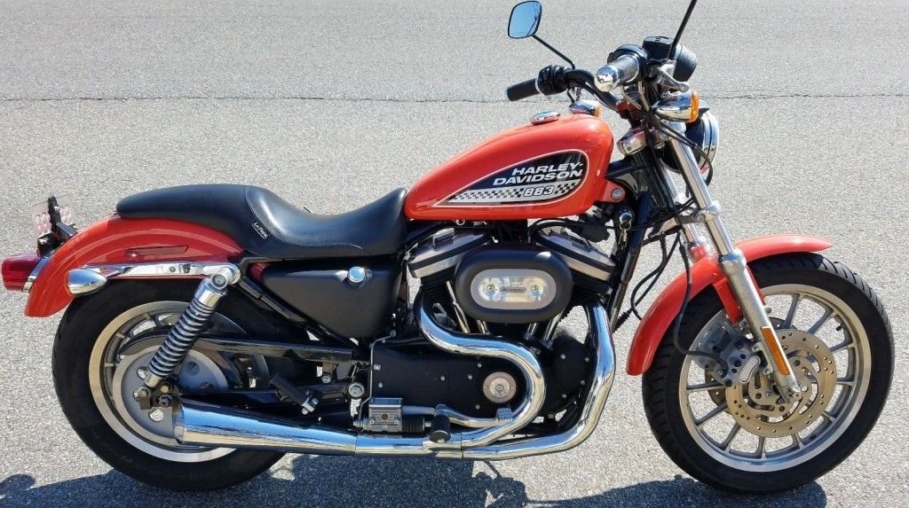

Then you might like the Sportster 883R 2>1 Stock Head Pipe with the Screamin' Eagle Slip-on ... I have that set-up also (internet photo)

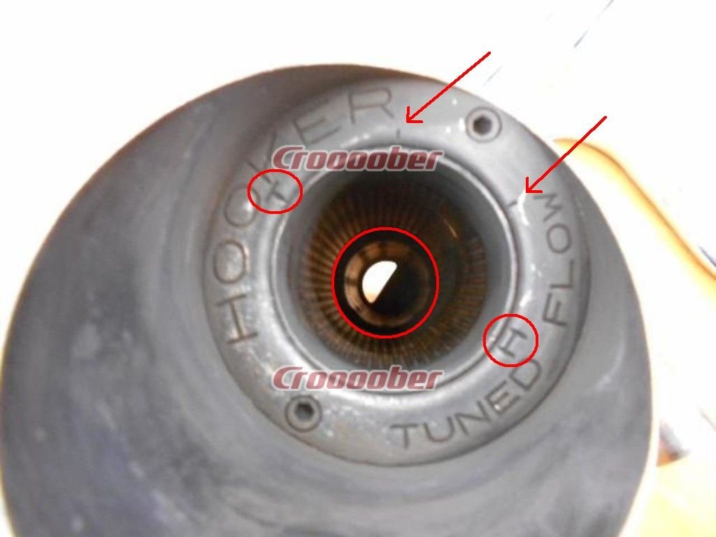

I have hopes that the Hooker would sound good ... I have had a set of Hooker Touring Slip-ons that I like the Sound of.
Interesting about Hooker's "Tuned Flow" ... you loosen the Screws and rotate the end plate to change the center opening to force the exhaust around the outside or not ... "T" for Torque, "H" for Horsepower
