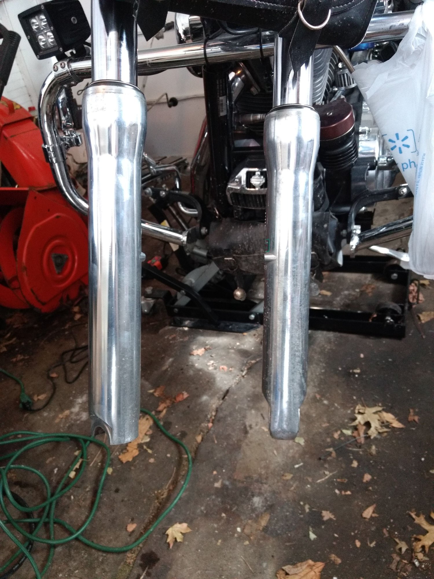

So I got the new wheel and rotor on after polishing up the lowers and raising the fender and fork brace back to the stock height. I wasn't particularly happy with the look of the front end afterword.
It didn't bother me before but I also had aluminum rims. I had thought about replacing the lowers with some chrome ones when the wheel was off but I'm glad I didn't now. I think I'm thrown by the chrome upper, aluminum lower, then contrasting with the black rim and chrome spokes. I think I'm going to like it better with black lowers so today I took the front end back apart to get ready to sand the clear coat off.
I'm planning on using some wet 220 then some wet 400 to take the clear off. I've got some Rustoleum bare metal primer and glossy enamel paint to try on it next week.

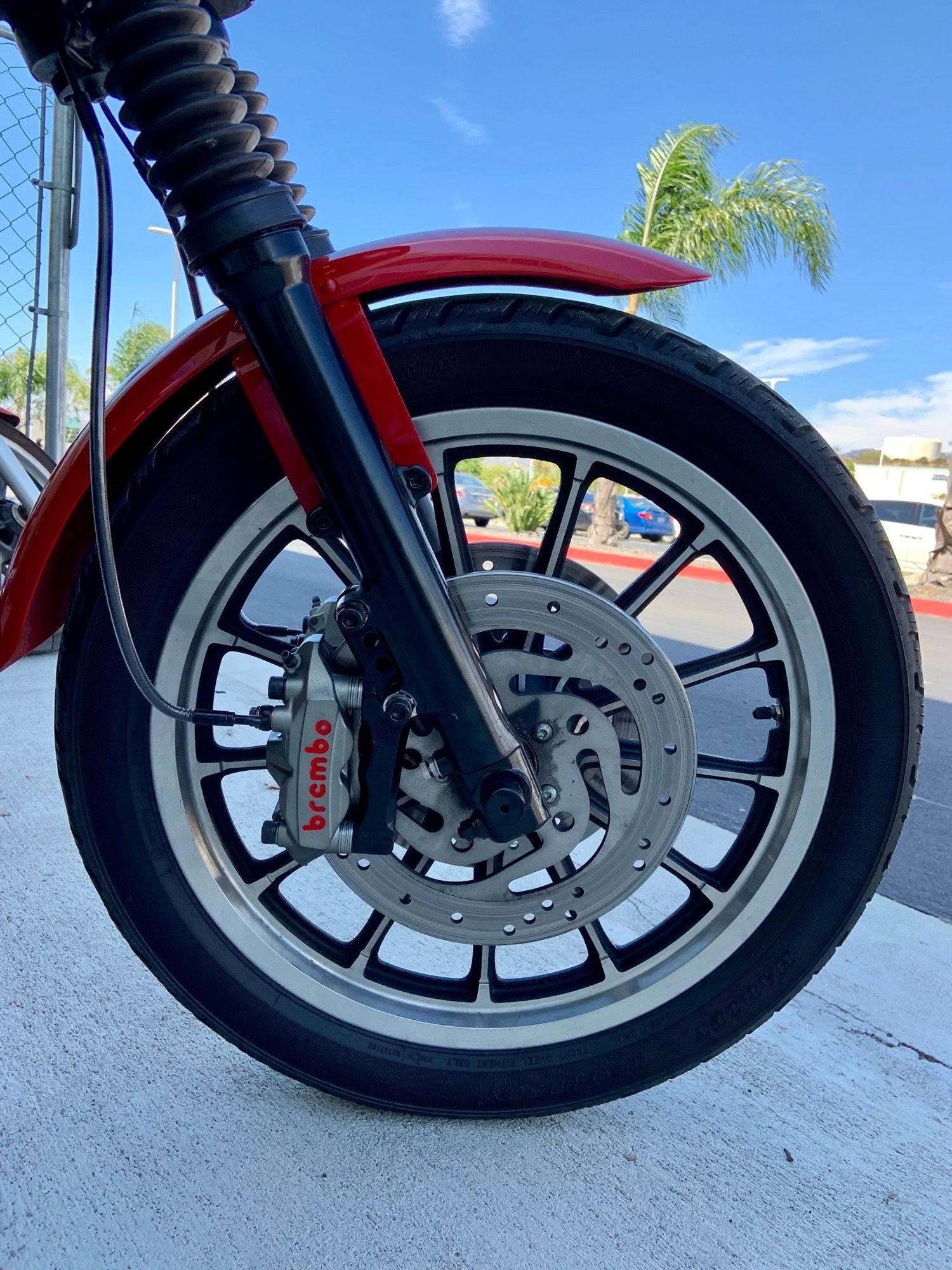

this is about 8 months post-appliance epoxy. It shines if you prep and hit it with a bunch of coats. 1 or 2 $3 spray cans vs disassembling whole front end/fork assembly, send out to powder for a couple hundred dollars, and then reassembly. I’ve done this to my last 4 bikes and it’s shiny black and dries hard rocks, holds up and doesn’t fade.
