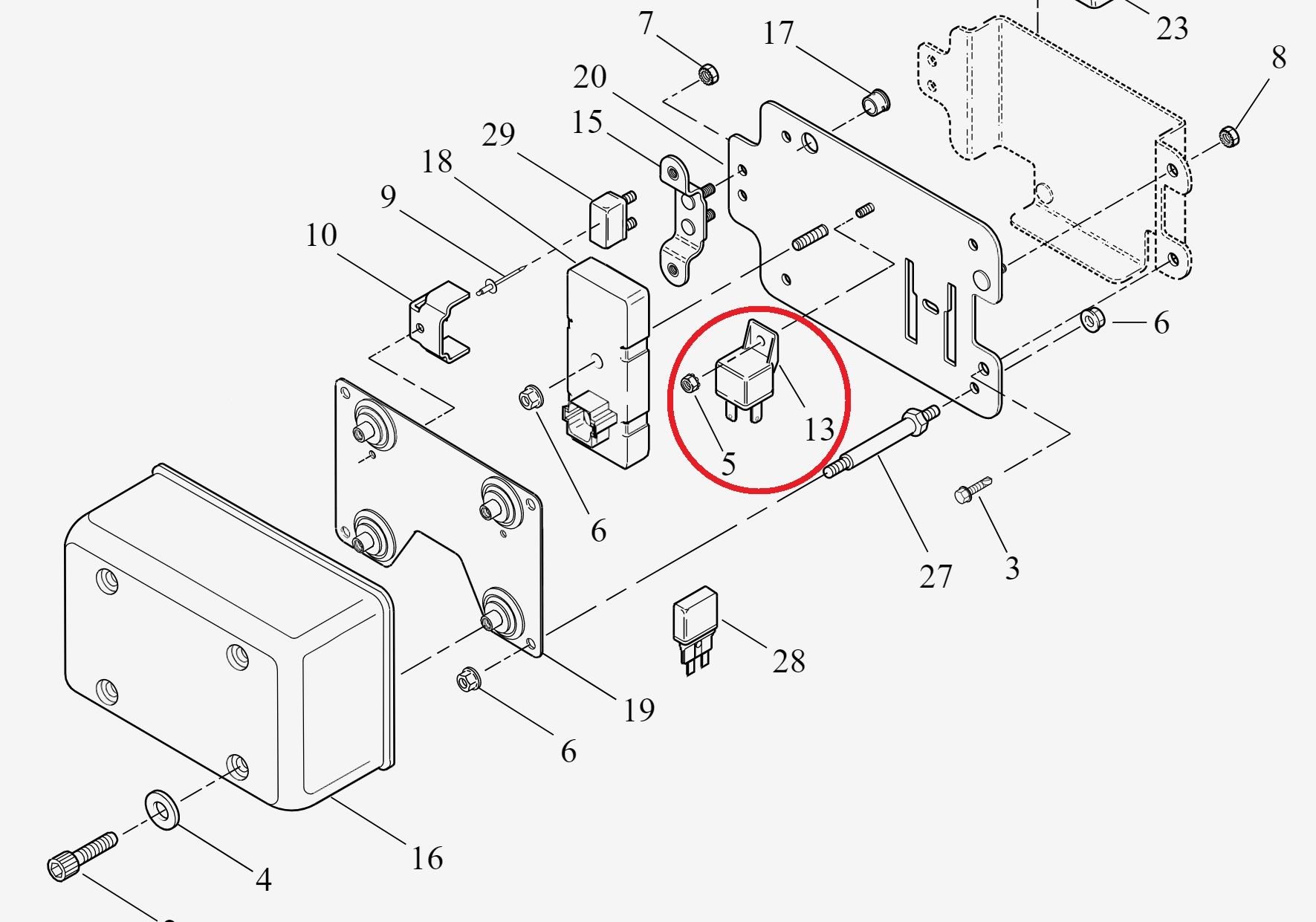

The starter relay is located behind the electrical cover and outer plate
Starter relay test (see image below):
  1. Pull out and remove the electric panel cover
  2. Remove the nuts securing the outer panel and remove the outer panel.
  3. Disconnect and remove the starter relay from the starting circuit.
  4. Connect an ohmmeter and 12-volt battery between the relay terminals as shown. This setup will energize the relay for testing.
  5. Check for continuity through the relay contacts using an ohmmeter while the relay coil is energized. The correct reading is 0 ohms. If resistance is excessive or if there is no continuity, replace the relay.
  6. If the starter relay passes this test, reconnect the relay.
