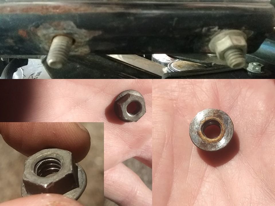

Greetings all:
Trying to ID a nut/bolt combo on the exhaust on this 2004. It's from a Screamin Eagle II mount, and it seems to have vibrated off. Anyone know a part number for this thing? Or where I could order a couple for cheap?
Tried Google, but not finding what I need.
Top shot is the mount and bolts, bottom is the nut itself. It requires a 1/2" socket to remove.
Thanks all.
Rob

If it takes a 1/2" socket then most likely it's a 5/16" nut you need, probably coarse thread. You can use a serrated flange nut like this:
or use a regular nut with lock washer and Loctite. Fairly simple fix either way.

Well, the Nut you lost wasn't working very good because it is a locknut ... look at the threaded hole of the Nut you have in your hand and should see that is slightly Oval instead of round
Anyways ... part# 7531
