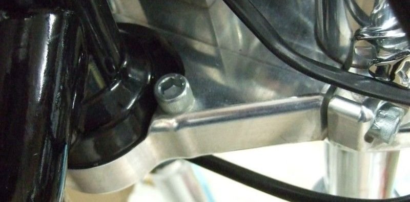

What do you mean "05 FXR" ? ... did you mean to say 05 FXD?
The Sporty should work (YMMV), but you'll lose the Fork Lock feature ... Dynas use a different Stem
Why can't you sand/file your broken stop flat, then drill/tap for a SHCS (socket head cap screw). The head (plus possibly a stand-off) will become the Stop ... it's done all the time
Do you mean like this
Like this

Like this
Gotcha!! that looks decent, nothing wrong with that!!

Like this
Looks Factory! I have suggested this very solution for broken stops many times before.

I did mean FXD, not sure why I was thinking FXR.
I will look into modifying the fork clamp with a screw stop. Mine is broken below flush so it will have to be built up with weld material, but that shouldn't be a problem. Sure, it's cast aluminum which tends to weld poorly, but we'll make it work.
Don't forget if you don't heat treat after welding the casting will be very soft.

Instead of building it up, maybe you could counter-bore it instead, and use a nut or spacer under the head of the bolt..
