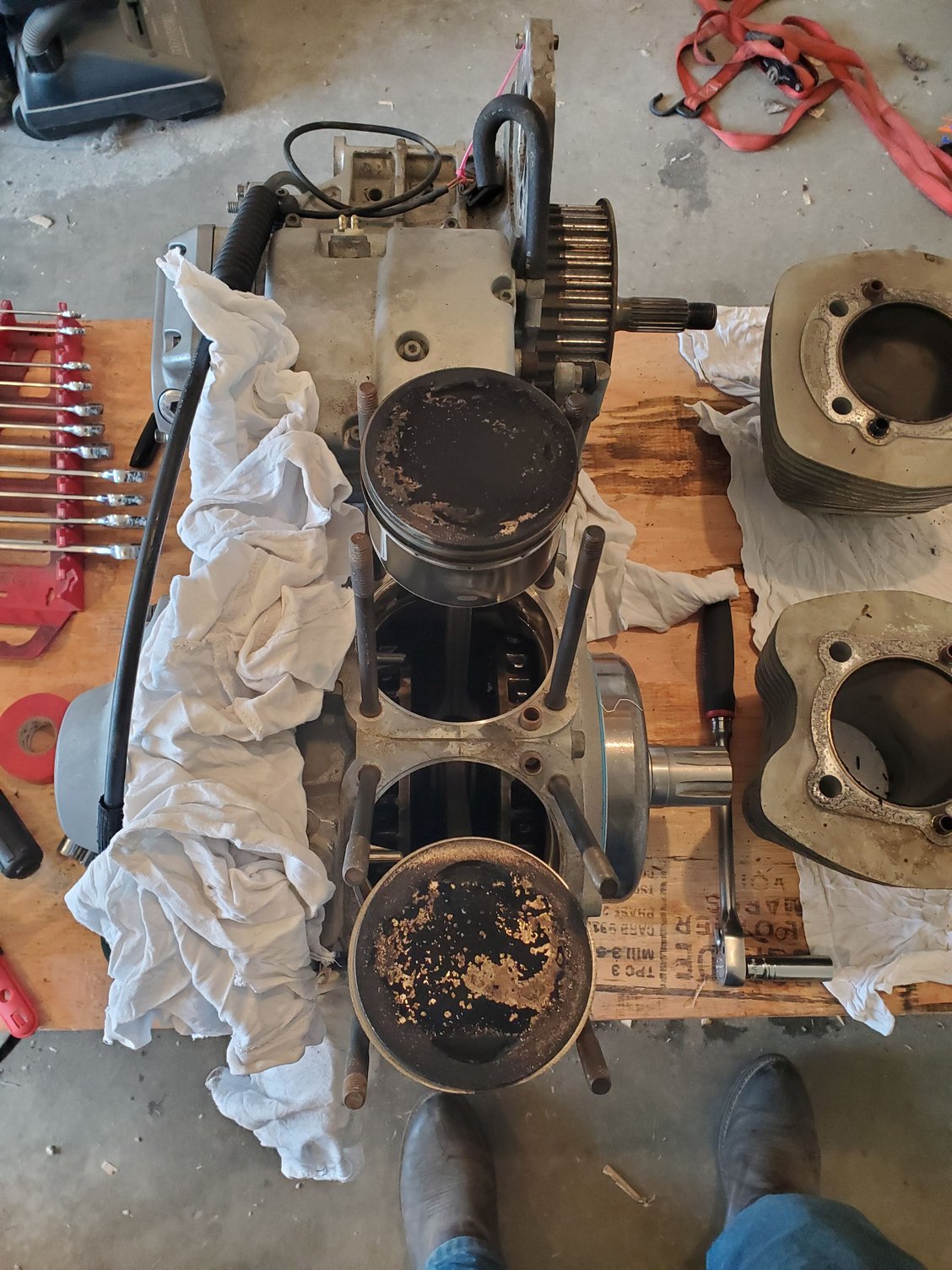

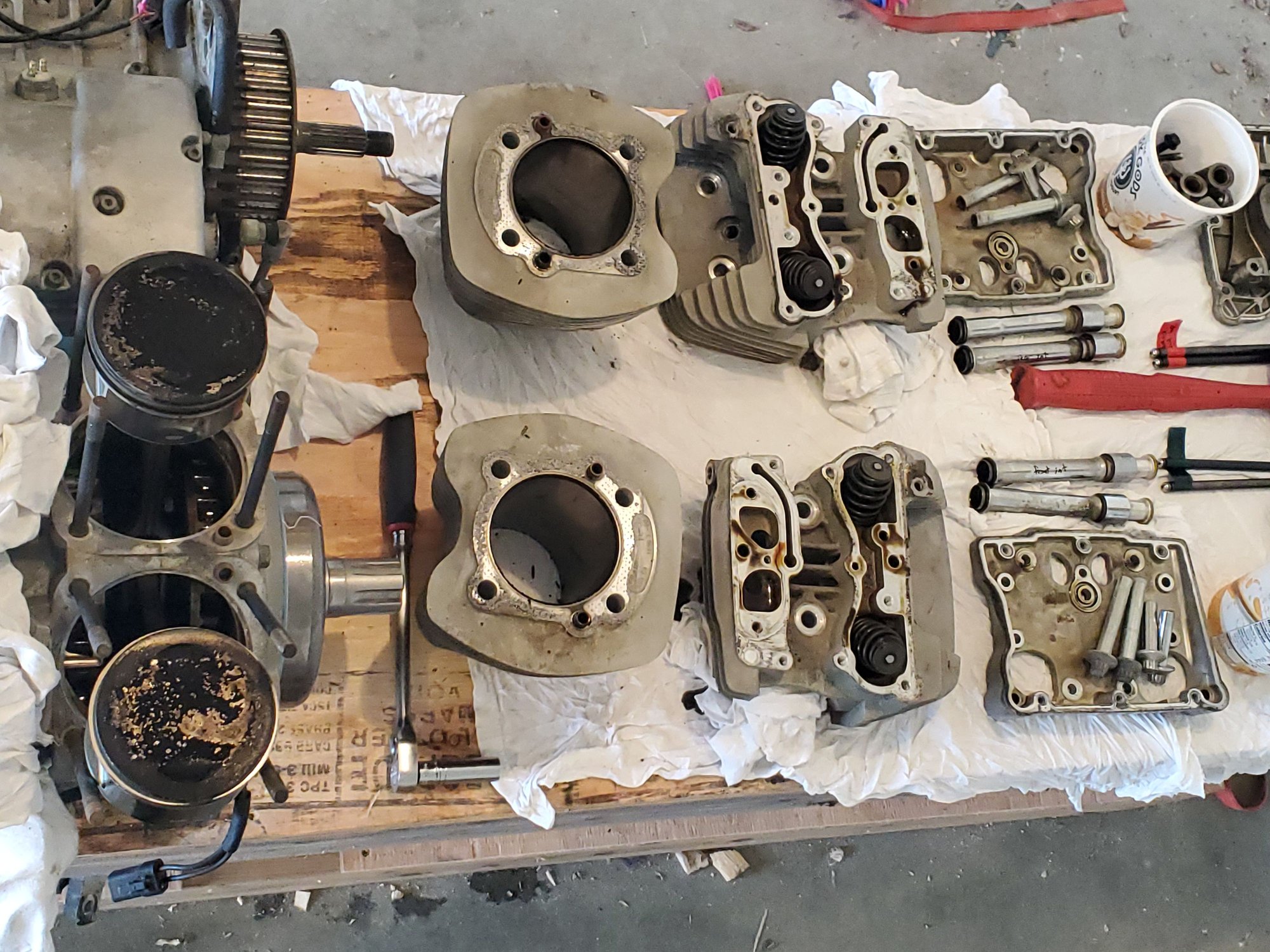

Got the top end opened up today. Some cross hatching is still visible on the cylinder walls, which was a welcome sight. Quite a bit of soot caked up on the pistons. It's unfortunate that I don't know the mileage of the machine, but so far everything inside is looking really good.

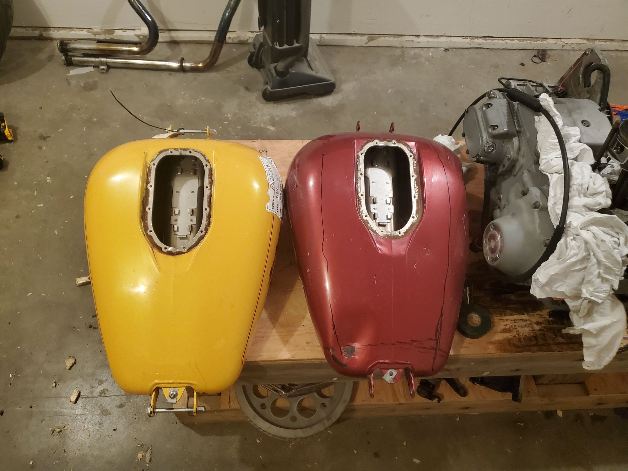

Finally, I ended up purchasing the eBay tank that someone linked to previously, and it arrived today. It looks good! Once I settle on a color scheme, the tank and fender will go to a local body shop for paint.
