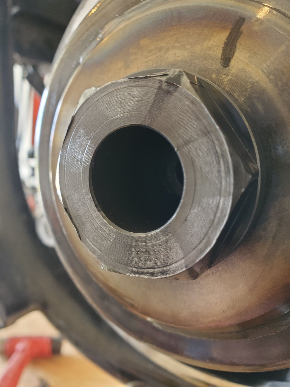

Today I jumped into the chaincase. The chain, clutches, and case all need to be removed to A) remove the belt, and B), pull the engine. I'm hoping to have the engine out this week, if I can rally some muscle to help. Found a couple things of note so far...
First, there was quite a bit of gunk on the drain plug. Not very impressed with that.
Second, there appears to be some rust on the primary clutch nut...
Third, there is damage on the chaincase cover. Presumably from the same wreck that damaged everything else. The handlebar stop is broken on the starboard side, and the tank is dented on the starboard side, which probably means the bike fell on the port side, which would explain this...
Finally, someone was definitely in here at some point in the past, probably with a crescent wrench. The compensator nut has some gnarly burrs on a few of the flats...
I'll be picking up the proper 1-1/2" socket this afternoon, and I hope to have the clutches and case removed today.

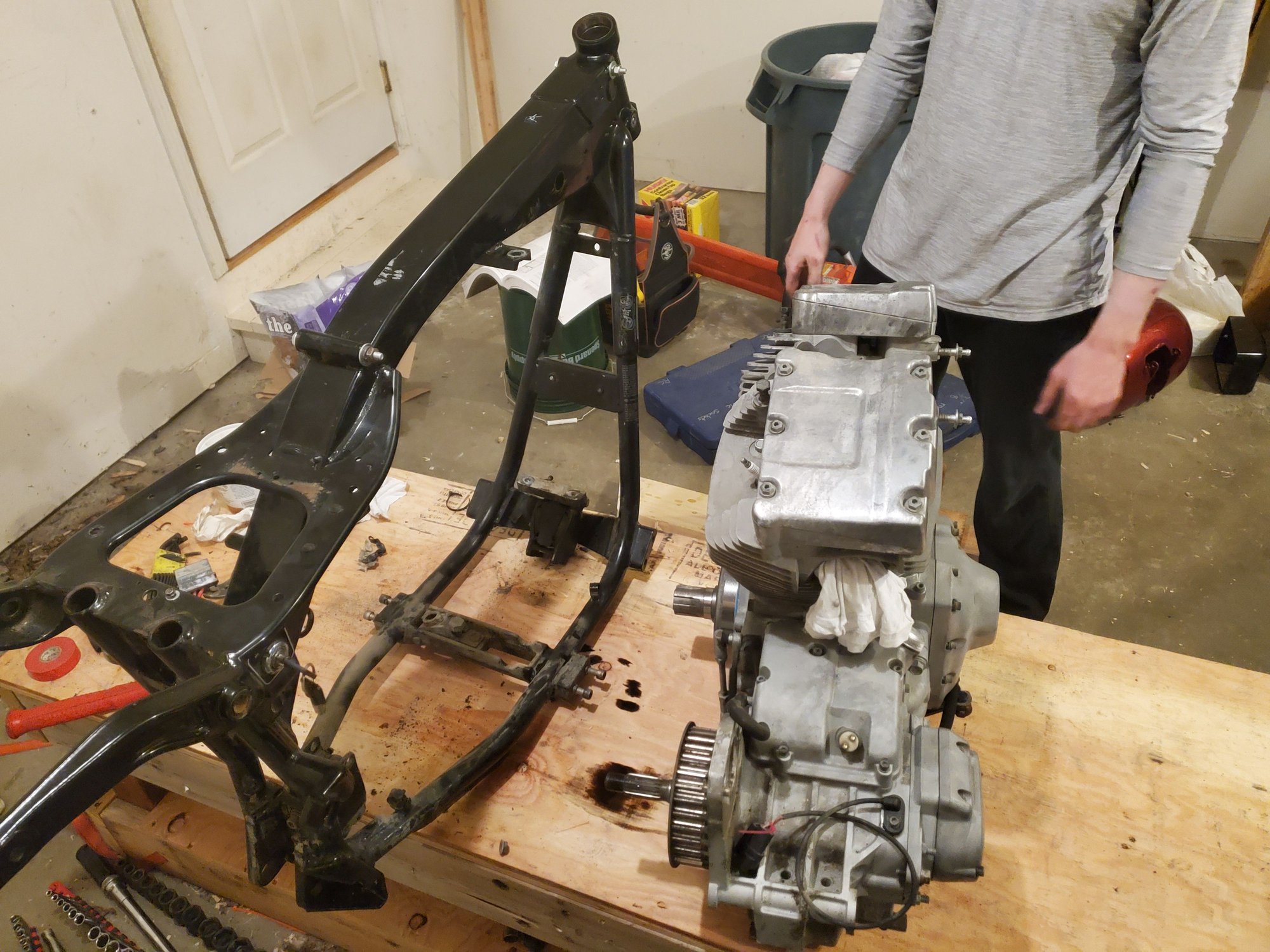

Well, a friend of mine happened to stop by tonight, one beer turned into several, and at last...
