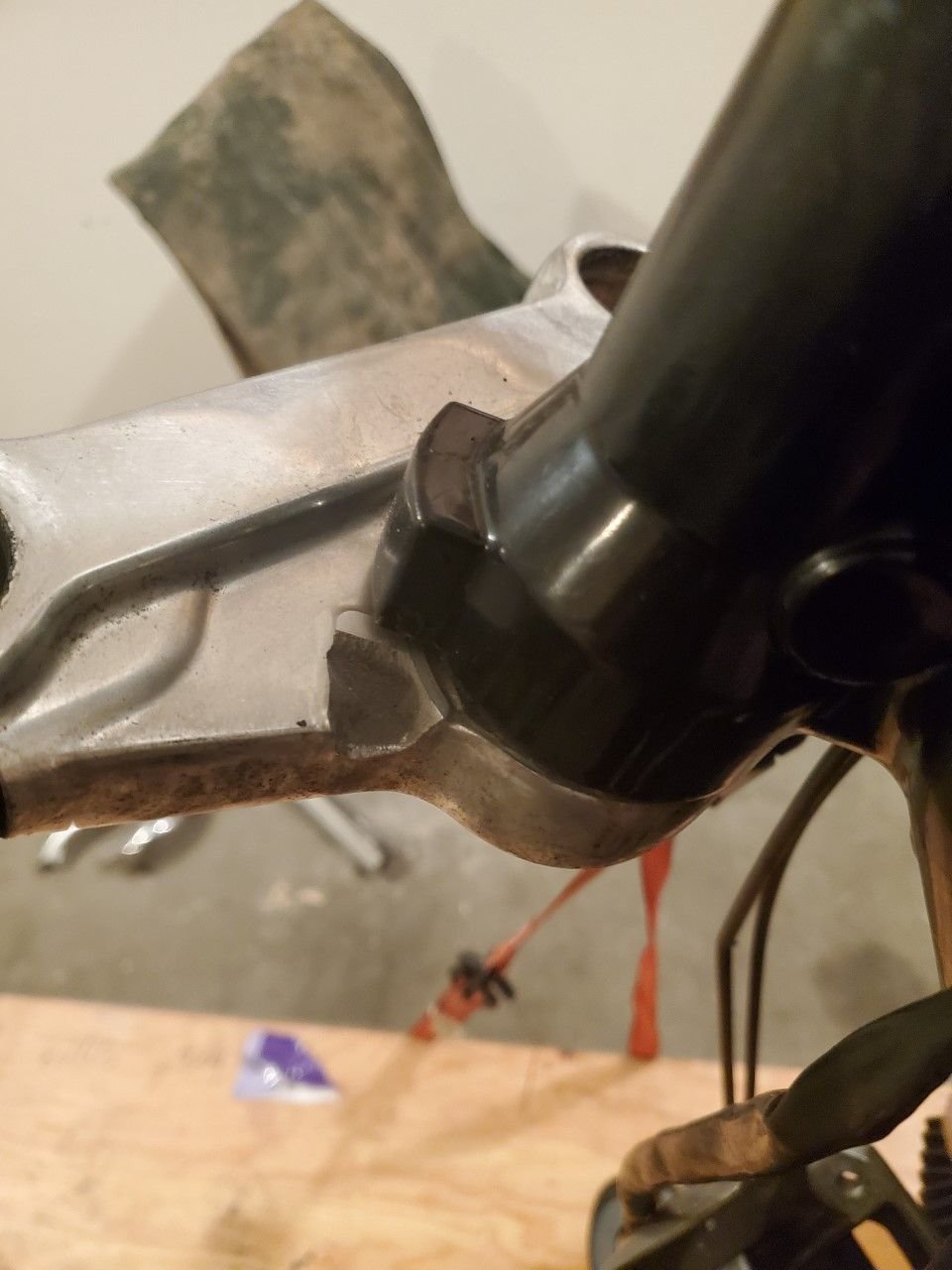

One thing that I totally missed on the pre-purchase inspection was this little gem right here...
When the bike crashed, it broke the stop off of the triple tree. Then the handlebars swung over and put a giant dent in the tank. I have a friend who operates a machine shop, and he's actually messed around with milling a few of these before, but it's pretty time consuming. I'm also considering welding a stop tab back on, because a new replacement is very expensive, and I have as yet been unable to put my eyes on a used replacement for sale.

Not sure what your definition of very expensive is, but $150 in my book isn’t too bad.

Man, that is pretty reasonable! All the ones I was seeing were $400-$1000 for an aftermarket setup, that's the first HD one I've seen. Thanks!
