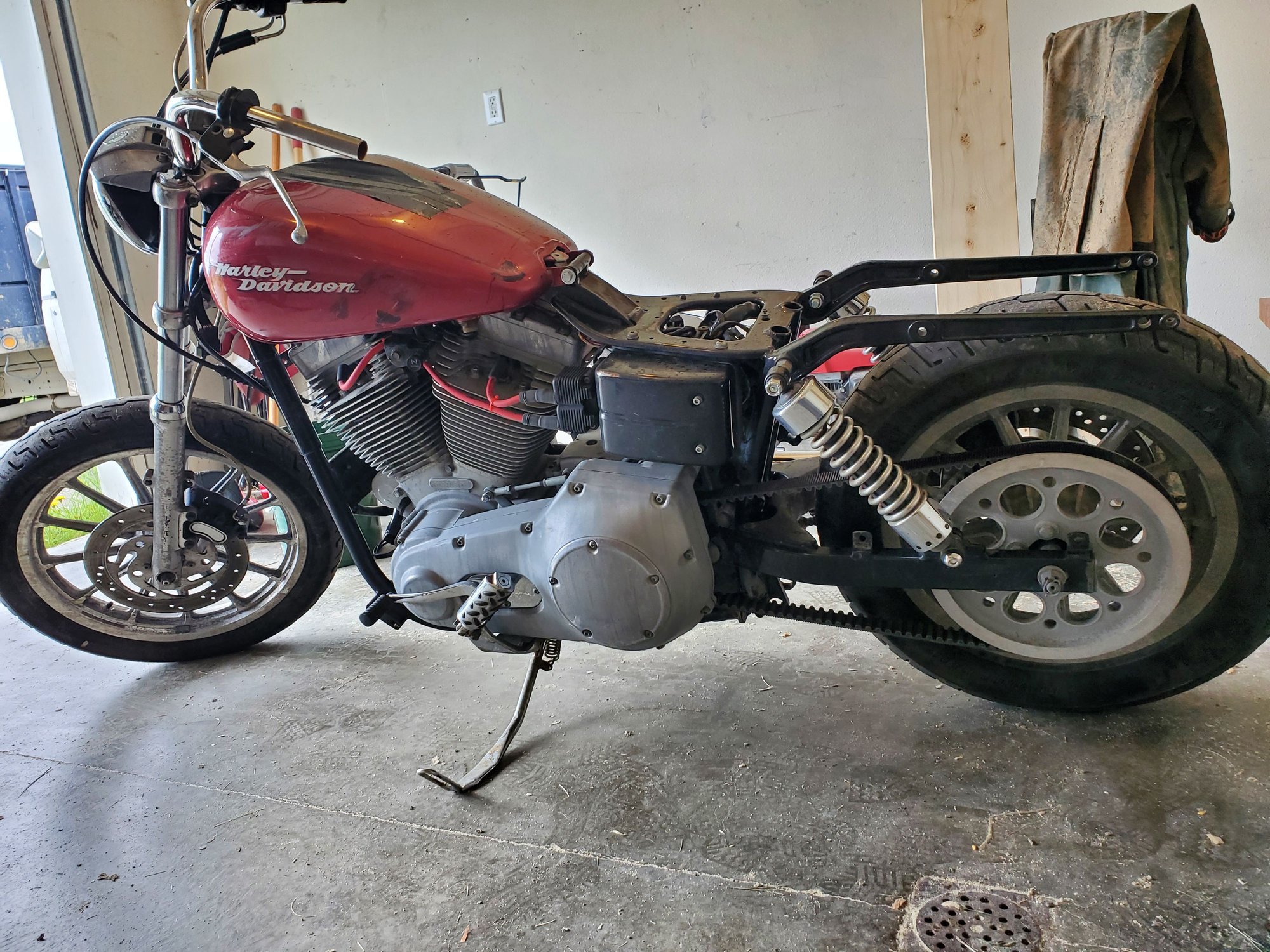

Well, getting the bike into my possession turned out to be a goat rope, but we finally made it happen!

Let the Games Begin ...
Btw, the engine "Finish" is starting to look like the "Finish" of the Pulley (the pulley's Non Machined portion) ... Never HD's intent

Ooh boy, and a game it will be...
I'm undecided about which way to proceed at this point. Half of me wants to just start tearing things down and get the frame and other parts off to powdercoating, and the other half wants to hear the engine run first. It's a carbureted engine, so in theory I should be able to rig up fuel, jump the starter solenoid, and it should fire.
On another note, regarding the wiring harness. A friend of mine suggested I just remove the harness altogether and take it to the "local" Harley shop and they should be able to repair it for me. So I'm going to explore that possibility.
Agreed, the finish leaves something to be desired. It will be corrected, though. Not sure how yet, but it'll get coated with something!

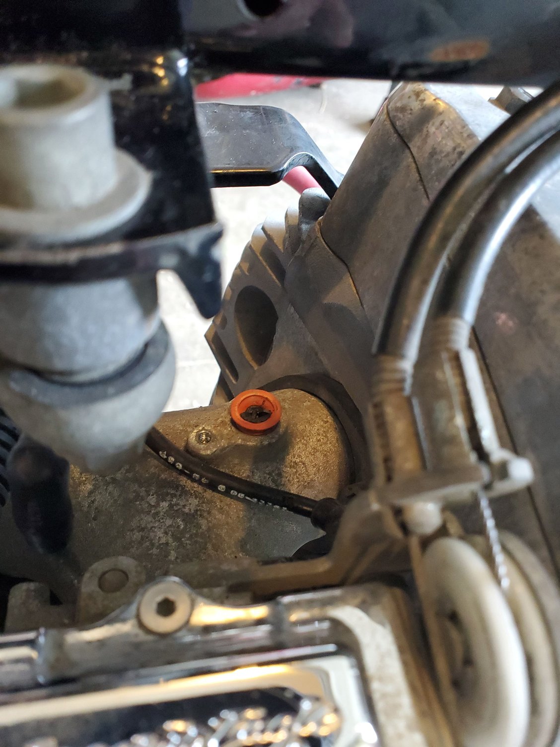

OK so here's my first question. What is this plug? The bike is carbureted, and this looks like a location for an O2 sensor on the EFI version of the bike, so hopefully this is a dummy plug? I say hopefully, because I broke it. I did hear from a friend who should know that it's a MAP sensor? Didn't think that the carbureted models had any of that.

Asked, and answered. MAP sensor. Gonna have to order a new one.

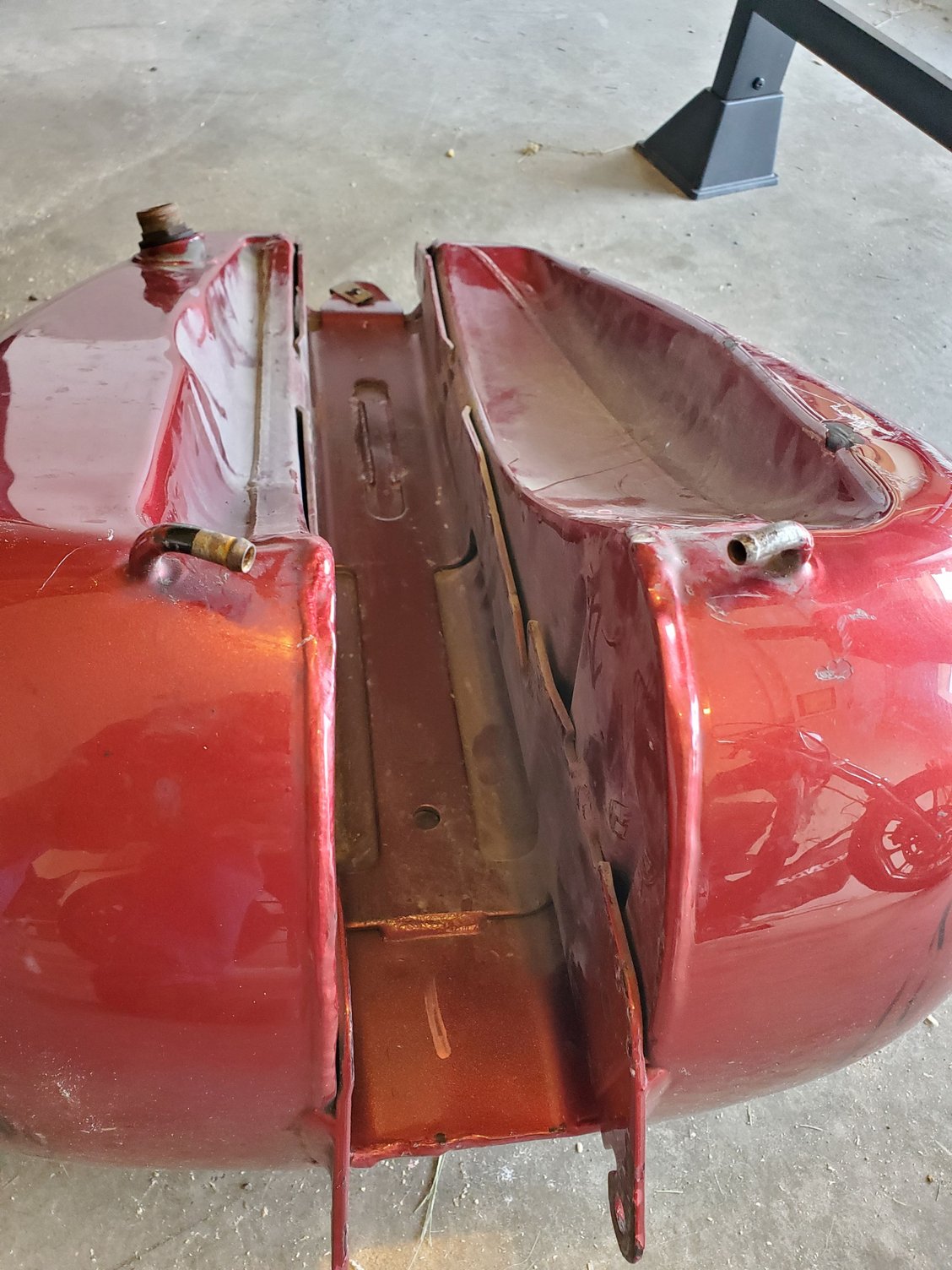

Next question. I assume these are fuel vents, and it looks like one connects to the bottom side of the fill cap. Where does the other one tie in? I see there's a port that looks like a hose barb, pointing directly down, on the aft side of the carburetor, with nothing connected to it. Is that where it connects?
