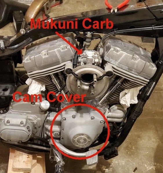

Interesting to see if any improvements were performed inside that Cam Chest, seeing as the Carb & backplate have been changed.
I noticed the change originally in this pic
I'm not familiar with a cam chest, but I agree, I'm curious to see what may have been modified. The Screaming Eagle plug wires and carb plate seem to suggest something has been done. I'm hoping to pull the carb off today, but I can't make sense of the two bolts that mount the air cleaner bracket to the heads. It looks like an oil port or something under each rubber cap, and then the bolt head is underneath that. I wasn't able to find much about it online.

That's a Mikuni Carb Not the Original Keihin CV ... Pull the Cam Cover Off and keep your fingers Crossed for the possible Goodness that awaits
