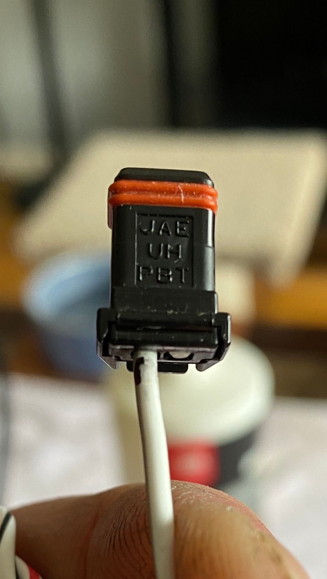

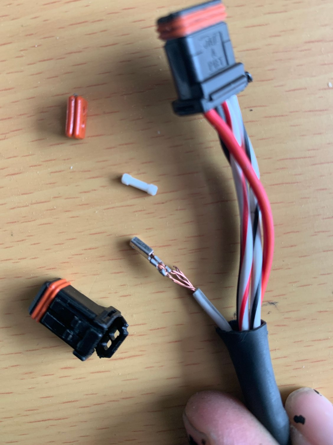

Doing a bar swap on my FXDLS and this connector on the right side hand control got hung up while coming out and got pretty chewed up. My problem is Im having trouble tracing what the single wire in the cluster is for. Anybody knowledgeable enough to help me, I can't seem to find the correct schematic. Furthermore, should this be recrimped or can I get away with soldering? Local indies, and stealerships are useless for keeping anything minor yet used often in stock. And how my local indie stays in business when they look at me like ive got 10 heads everytime i bring up my bike that was made after 1985 is beyond me. And the local electrician supply stores are closed because the ronas.

I don’t have my manual with me right now to tell you where it goes, but you’ll be hard pressed to solder it and still be able to get it to fit and lock in the connector housing. Also it isn’t easy to crimp that connector so it will fit unless you have the correct crimp tool.

Next time take the pins out of the connectors before you brute force them through!
That’s your run/stop switch
If you look at the parts diagram, depending on how bad you mangled the connector you’ll need:
1 x 72910-11 - the pin
1 x 72906-11 - 2 place housing itself which is a JAE MX1900
And if you want to do it right, a crimper like this. I’ve been told you never solder canbus wiring, always crimp.
Amazon Amazon
Once you get it back together the wire goes here:
Note that you are looking at the underside of the connector, the side opposite the latch.
And just to say, if your dealer doesn’t stock these connectors, you need to find a different dealer. These JAE connectors are used in every modern Harley. They should have plenty of these pins and connectors in stock.

I thought it was run/stop.
Crazy to say that I didn't even brute this one out. I took the pin out of the connector and then noticed the fray which is probably from the previous owner's bar swap. Im first to take blame for my screw ups like i did with the TBW(which was the only one that got hung up coming out) but this, came out in one piece.
I won't be the one recrimping the wires, ive got an electrician friend that does his electrical work on his own bike to just help me with this quick fix.
And as for the local dealer not stocking these, I said the same thing. They didn't stock the pins for my TBW which I had to order to my house. And the guy I mainly deal with was equally astonished they weren't in stock.
