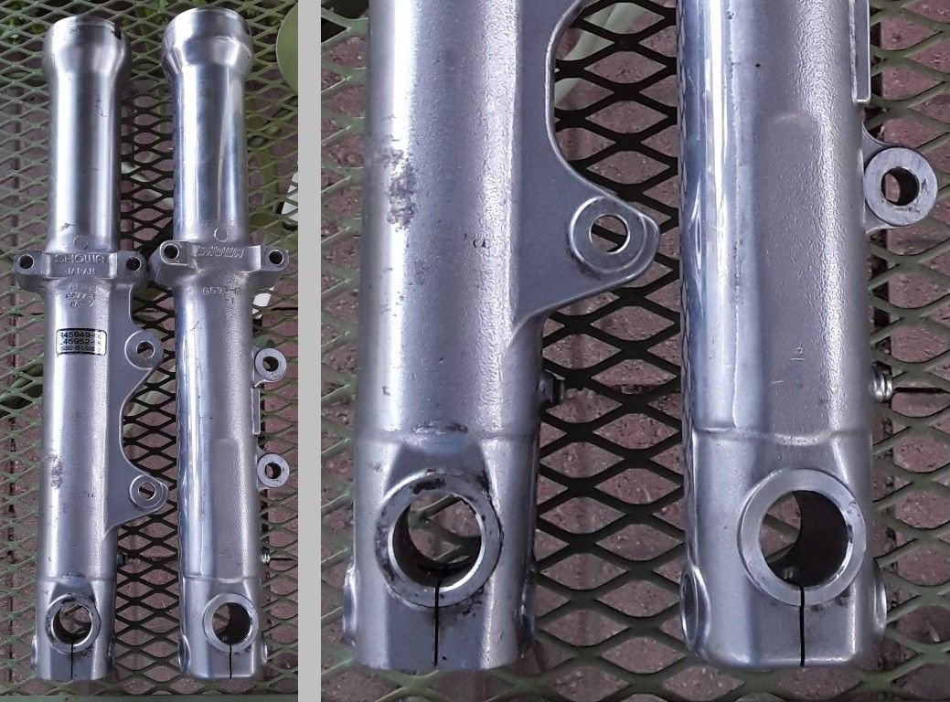

one more for ya @multihdrdr before i go down the Ebay-rabbit hole: Are there years of the sportster lowers that would fit? Maybe 04-06 since they’re 3/4” axle?

BTW, besides the caliper mount difference, here's the cast-in Flat for Rotor Bolt clearance for the 2000-later wider hub
2000-07 Sportster
2000-03 Dyna

Found a clean set with PART #s R45900-00 & L45901-00 on them. Looking that part number up it looks like that would have been for a 2000 sportster.

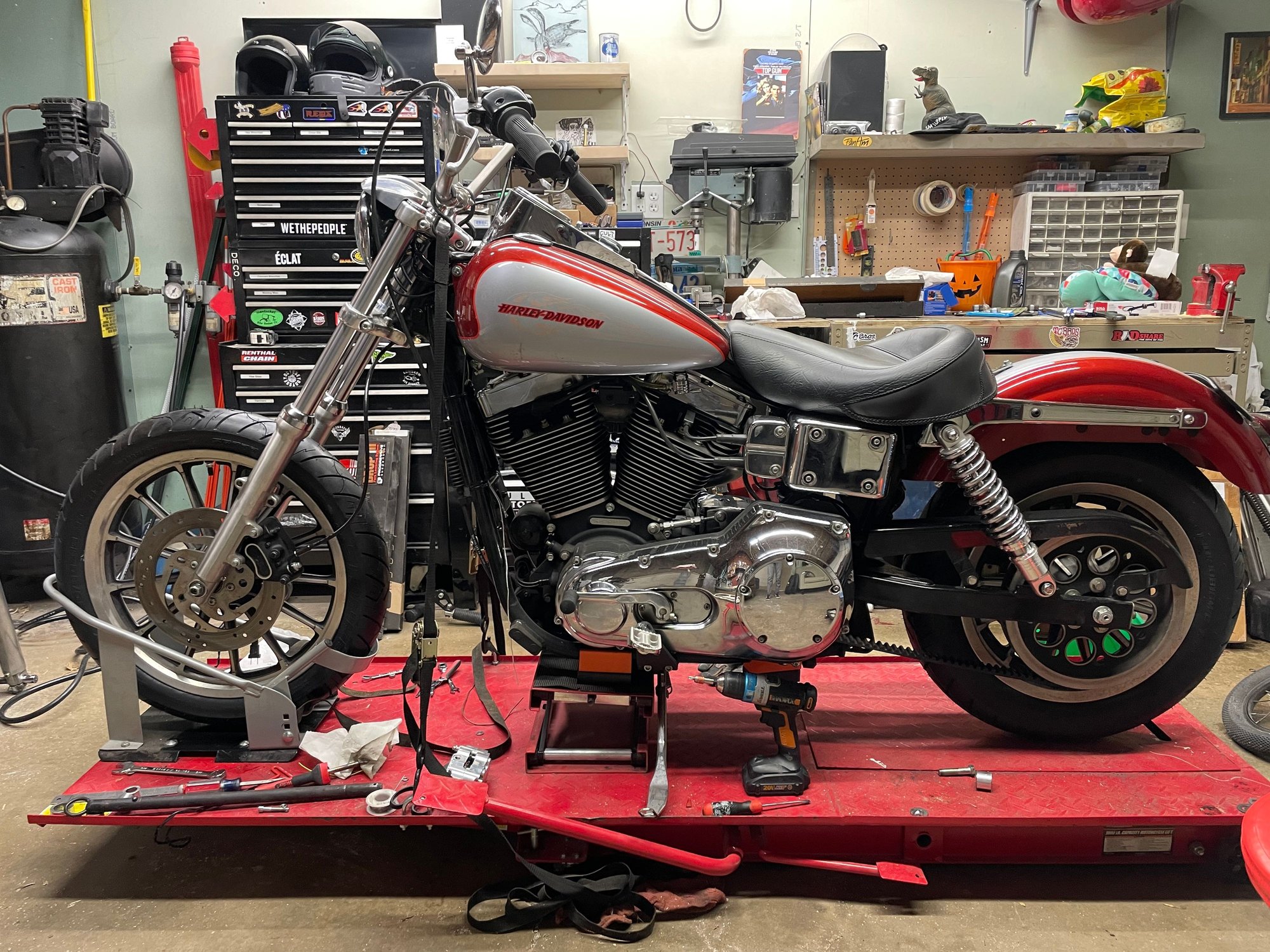

got the front end squared away, thanks again @multihdrdr !
pumped on the mags
