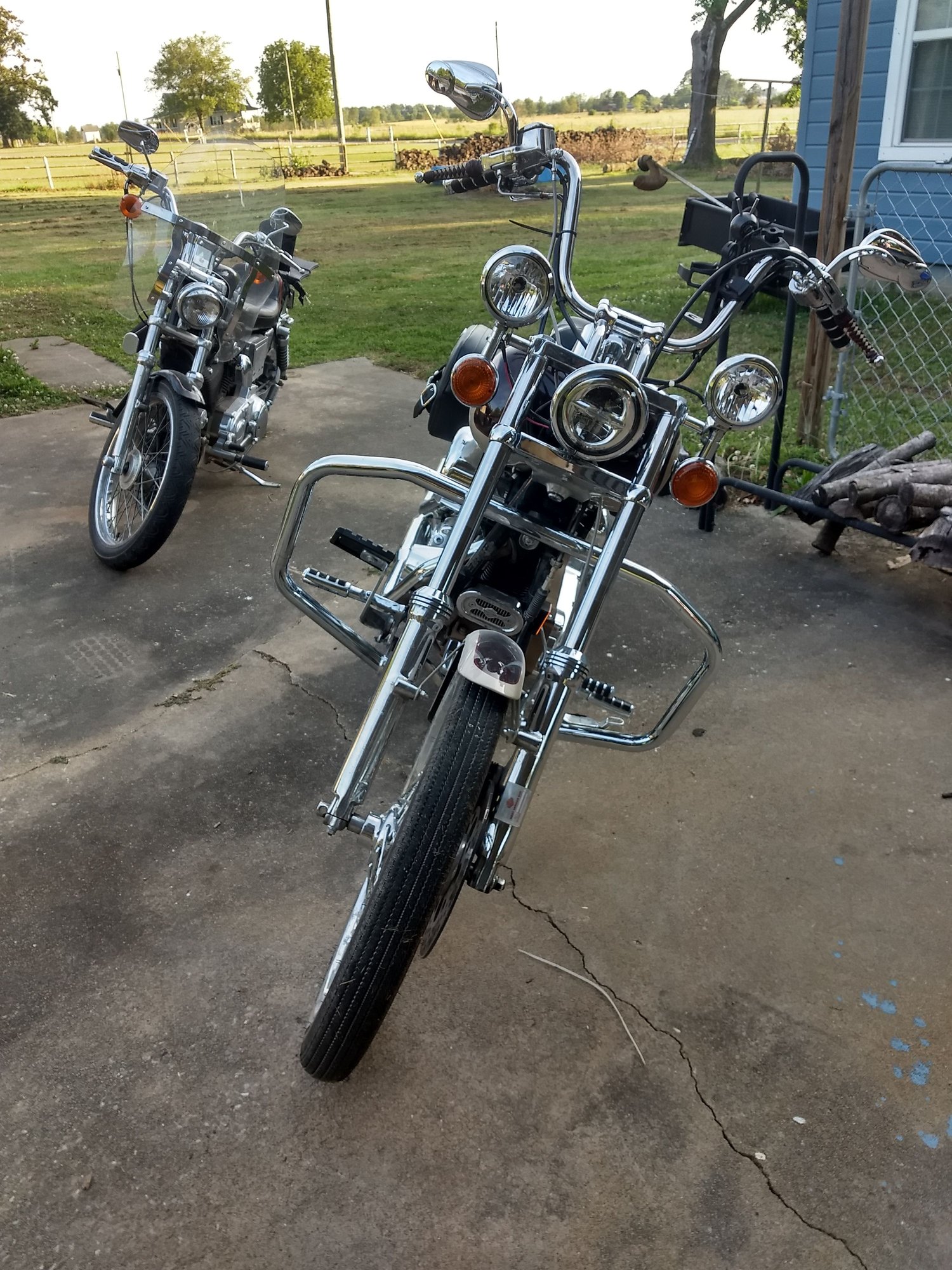

This standing Angle isn't right or is it?

Maybe someone with a 99-earlier FXDWG will stop by and confirm some measurements
Mine (99 DWG) were 32" UNLOADED (off the ground). Unfortunately, I don't have a record of the length with any sag.

Originally Posted by Rchilton
What can I do about this?
Stand isn't bent.
This, a kickstand wedge or shorter tubes or longer kickstand if it's got that dicked up dyna style mount .

Well, it's a Dyna (in the Dyna Section) ... So yes, it has a dyna jiffystand mount ... Wedge, No Worky ... (and usually used on Lowered bikes)

Then I'd say he may want to get under it with a mirror and see if something broke or cracked the frame, welded 2 that gave out there on the mid mount like the dyna's. That wasn't one HD's brighter idea's.

Of course in the Pic the forks "look" long, but pics can be deceiving so ..................
Yep about the deceiving looks. The OP's bike looks like it's leaning way too far to the right, but his house looks like it's falling over to the right also. That being said, it sure looks like the forks are extended like everyone else said.

How long are the shocks out back? Eye to eye?
Also, you could probably raise the fork tubes in the triple clamps with out too much fan fare. Couple inches and try that.

Here's an untouched pic from ebay ... anything look amiss
Originally Posted by NORTY FLATZ
...Also, you could probably raise the fork tubes in the triple clamps with out too much fan fare. Couple inches and try that.
You can't change the Tube position ... Top Tree does not clamp around the OD of the Tube

More confirmation of Stock Length...
Here's from another thread
Originally Posted by GREENOHAWK69
97 WG fork length ~ 31"
And the while I was at the Dealership today, I saw this 98 WG ... 30-3/4"
