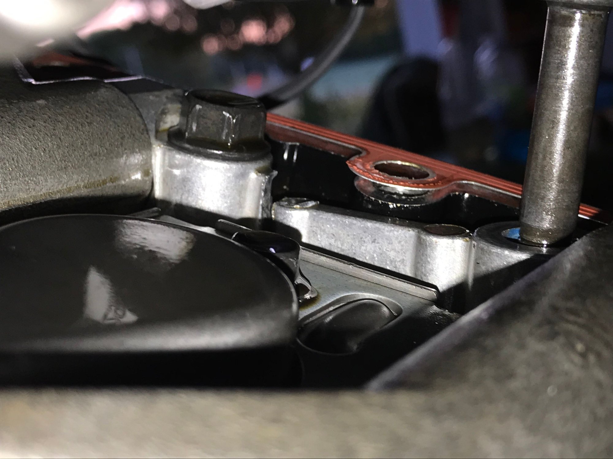

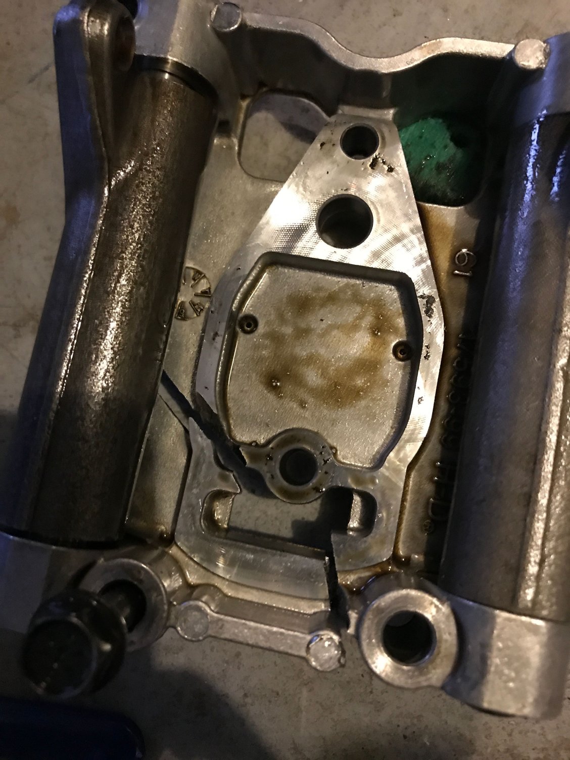

So I’m about 800 miles into my “new” 117 build and I was riding home this afternoon and started hearing a tap-tap-tap that was matching my rpm. My mind instantly went to pushrods. I got home, let it cool off and re adjusted. Started it, same noise. Next I open the front rocker box and thar she blow!
I’m an engineer so yes, I use loctite and a torque wrench on EVERYTHING. My question is will I be ok just getting another HD plate or do I need to drop some coin on a billet plate? It never crossed my mind during the build because honestly I hardly hear them mentioned as essential upgrades. What do you guys think?

Drop it! Drop that coin faster than you can say schizzle me grizzle!
Don't even hesitate, you broke that die-cast hunk like it was a month-old donut sitting in the store front window!

I have called every dealership within 100 miles and nobody stocks either the stock or forged support plates. On top of that the aftermarket billet plates are out of stock everywhere i've looked lol
