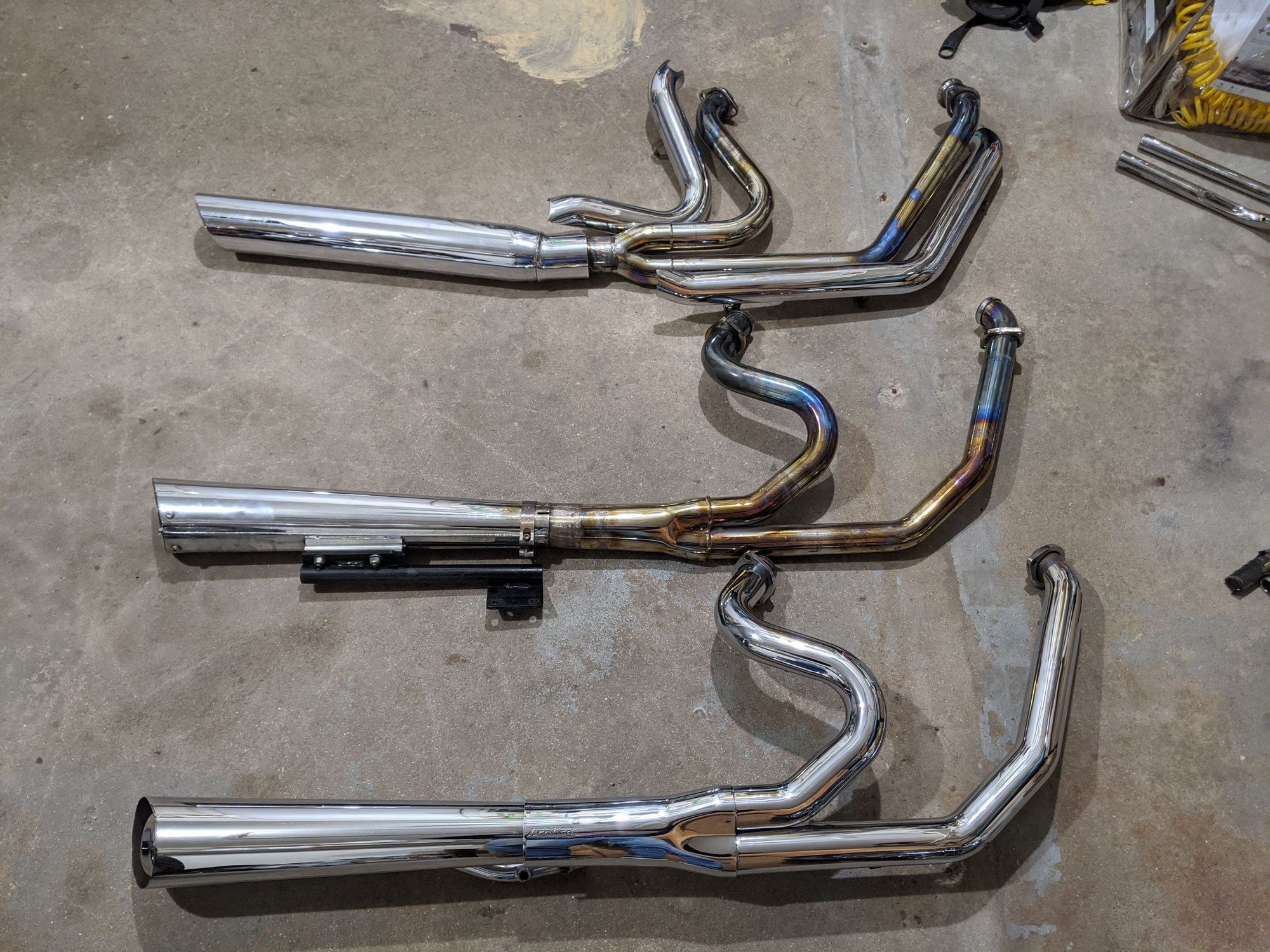

I have a Supertrapp that I run on my Evo as well. I like to change things out from time to time. Quality is very good probably not as good as D&D but it is very good.. One of the best things I like about the supertrap pipe is the collector.. It's more streamlined than most other pipes out there which works very well when you're into the higher rpm ranges. But the nice thing about it is that you can also tune it for low end.. It's one of the most versatile pipes out there for the cost.. I think I paid $675... I ended up taking all of my discs and open end cap off and I just run it wide open and it sounds excellent... In the picture below there's a Kirker on the bottom a Supertrapp in the middle and the D&D on the top. If you look at the collector between the D&D and the super trap you'll see how the super trap is more streamlined than the D&D. This is why the D&D has pretty good numbers for torque but yet still breaths very well up top. They offer two baffles with the D&D perforated which is very loud or louvered which is still loud but better for all around street performance.. The Kirker pipe is not tunable even though it's identical to the Supertrapp in design it just comes with a trimmed wide open end with a perforated baffle. They are very loud and very good over 3000 RPM. I hope to put my supertrap back on before the weekend is out and if you want I can send you a video clip of it. If you think that on the supertrap the pipes are too blue because it's too lean it's not.. I run my motors 13.8 to 14.1 AFR's because lean is mean..
WOW! Those are all very close to each other. Thanks for the comparison and the info. If you ever got video of it, by all means, go ahead and send it if you don't mind. It'd be appreciated!
