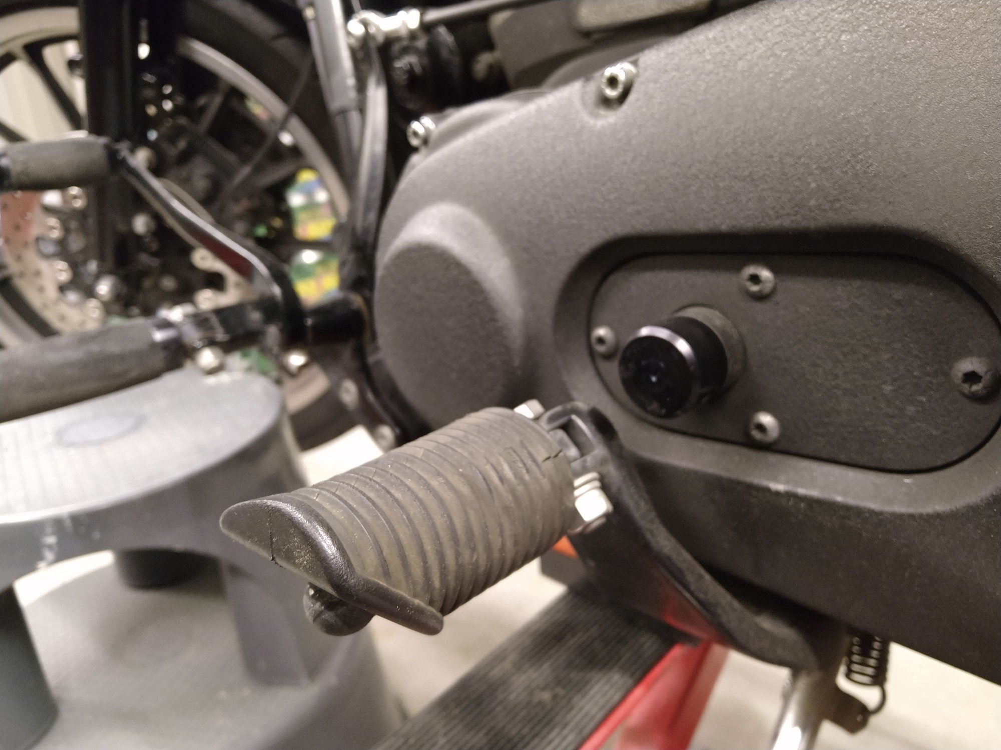

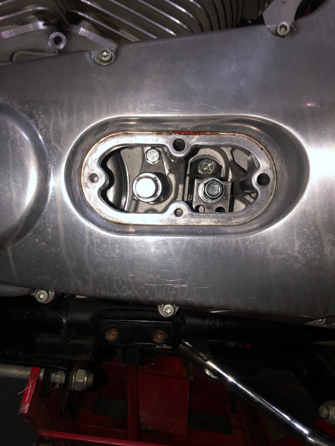

When I purchased my fxd it came with forward controls. I did the mid Controls conversation and when I got to the last piece to complete my puzzle “inspection cover” would not fit over the shift shaft almost like the shift shaft was off center a bit. Has any one had this issue? Please help .
This is without the cover
And this is the cover not fitting

Looks like you have the wrong one. You need 60529-90A or equivalent. Maybe that one is from a softail which has a different primary...Whatever it is, it's not the right one.
Primary inspection cover google search for 60529-90A

Would you know if a fxd outer primary would fit a softail inner primary? Reason I ask is I wonder if the previous owner changed the inner primary for the forward controls or whatever it might have been and this is the reason the shift shaft is slightly coming out the primary lower than it should be?

What i would do is look for cast mark/part No. on the inner and outer primary cover. Most likely something like: "XXXXXX-YY"
