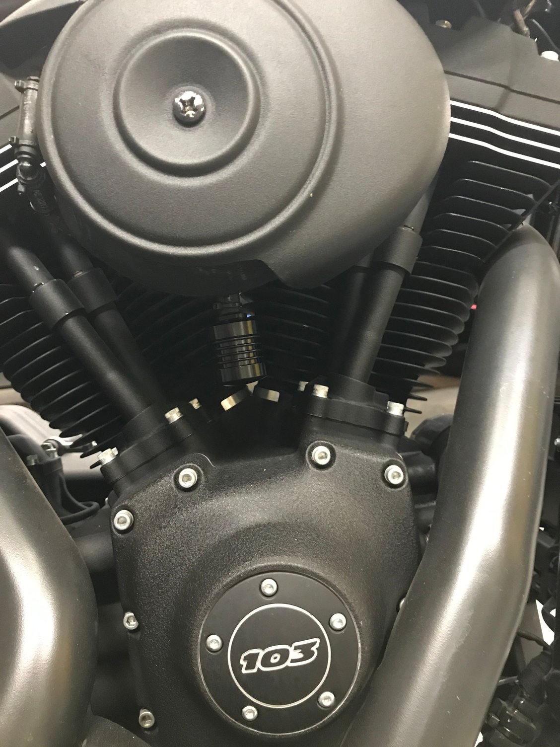

OP - I like what you did with those shells there, very cool
Originally Posted by Dynaglide92
Those little filters get clogged quick. I removed mine and now run the lines below the frame👍🏽
x2 - I had a filter clog up under the frame there and burst the lines off the T fitting. Filter under the AC cover just put oil on the side of the bike and my pant leg. No more filters on any of my bikes. Catch can is a nice alternative solution that I may incorporate one day if needed.
Here’s a clean and simple setup I recently did with my Fuel Moto backplate:
