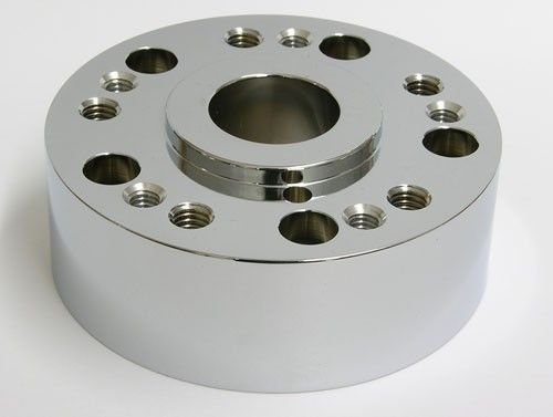

Originally Posted by Jarred Hare
... 39mm wide glide conversion ...
Who's kit is it ... link?
Why does your wheel spacers look like they have a different OD (outside diameter)?

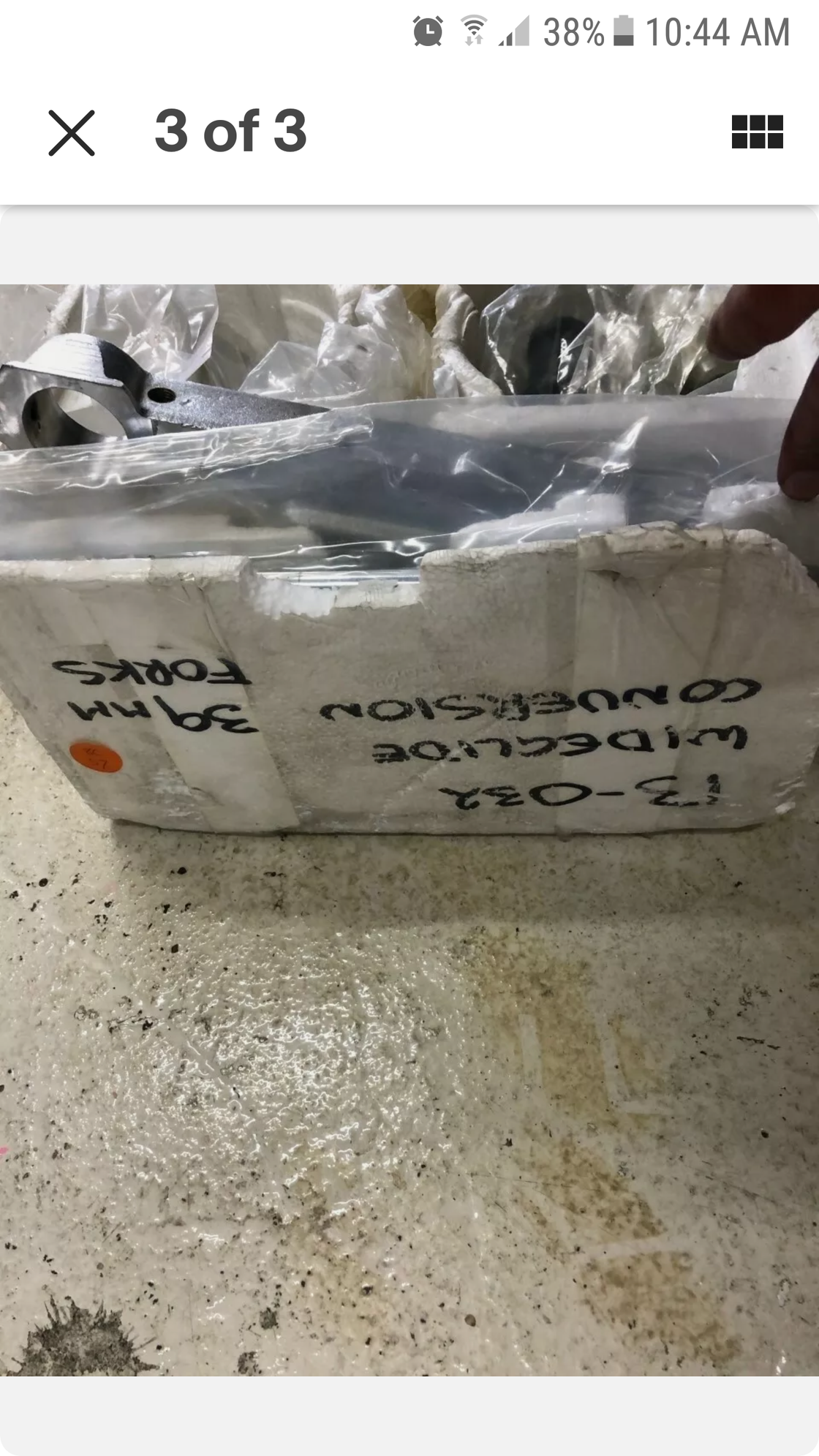

Brought it from aussie in a kit but seems bits missing. No name onit streering stem was wrapped in usa grease paper seems to be the same as a evo softail custom the parts i got look the same on ronnies harley parts diagrams. Think ill get a engineer to make up spacers

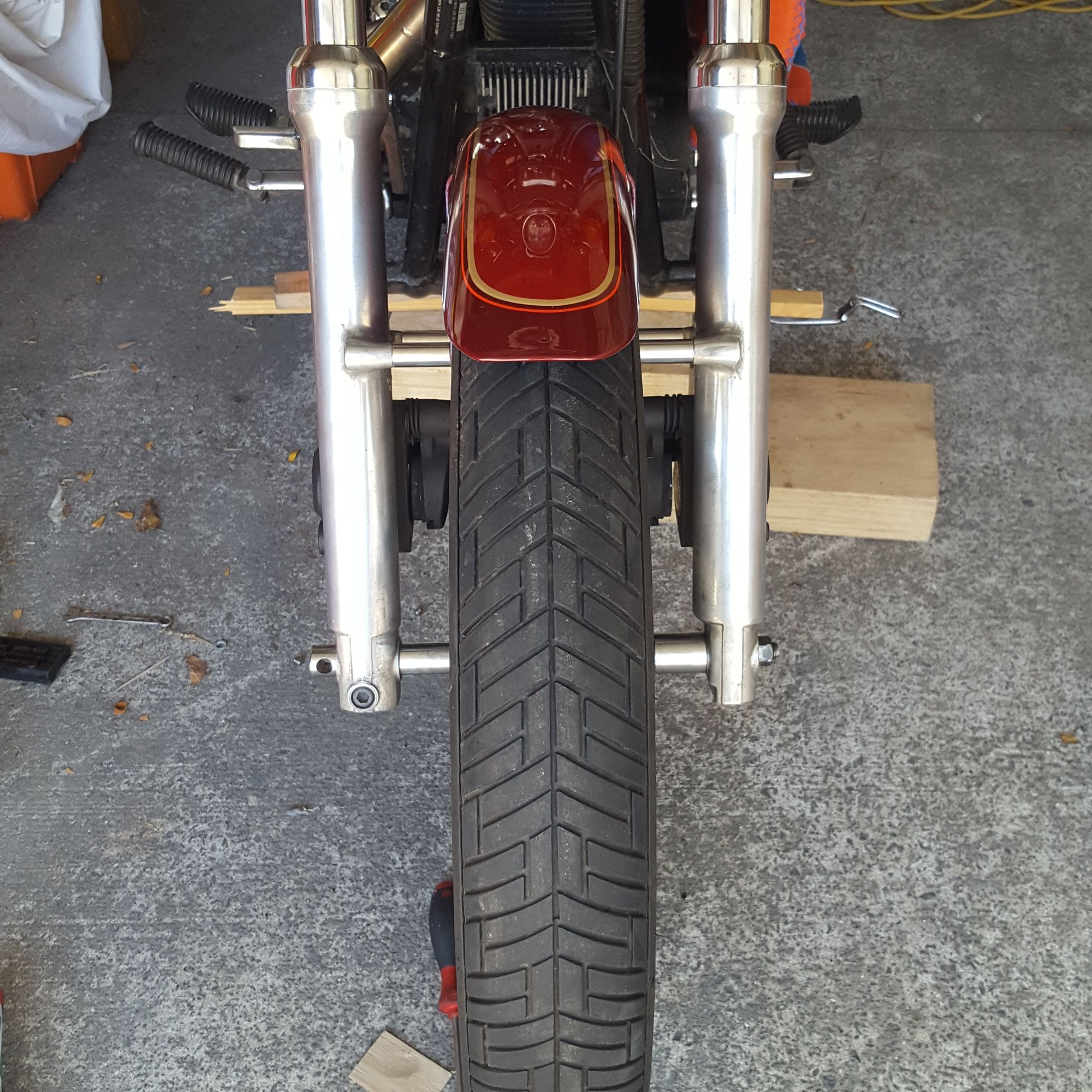

I did a measure around 35-36mm for a spacer
Mocked up
Box of bits i got off ebay

35-36mm might be about right.
Really for your application it can be as simple as this ... subtract the fork tube center-to-center dimension of new wideglide Trees from your original narrowglide trees (they are 7") and then divide by 2 ... that's the dimension you reference to make all the associated parts.
For example, the Harley "Wide glide" dimension can be a few different sizes (or any custom size if you're making all the parts), but let's use the evo softail custom (FXSTC) you reference.
That has 9-7/8" Tube centers ... so 9-7/8" - 7" = 2-7/8" ÷ 2 = 1-7/16 (1.4375" or 36.51mm)
In that example 1-7/16 (1.4375" or 36.51mm) would be your Rotor spacers, Fender spacers, and the dimension you would add to your existing wheel spacer lengths** (**the Right -side wheel spacer length would really depend on how they made the longer axle's "shoulder").
But all that aside, if they made all the parts correctly (Big "IF"), the length of your fender spacers is what the the Rotor spacer width should be ... YMMV
