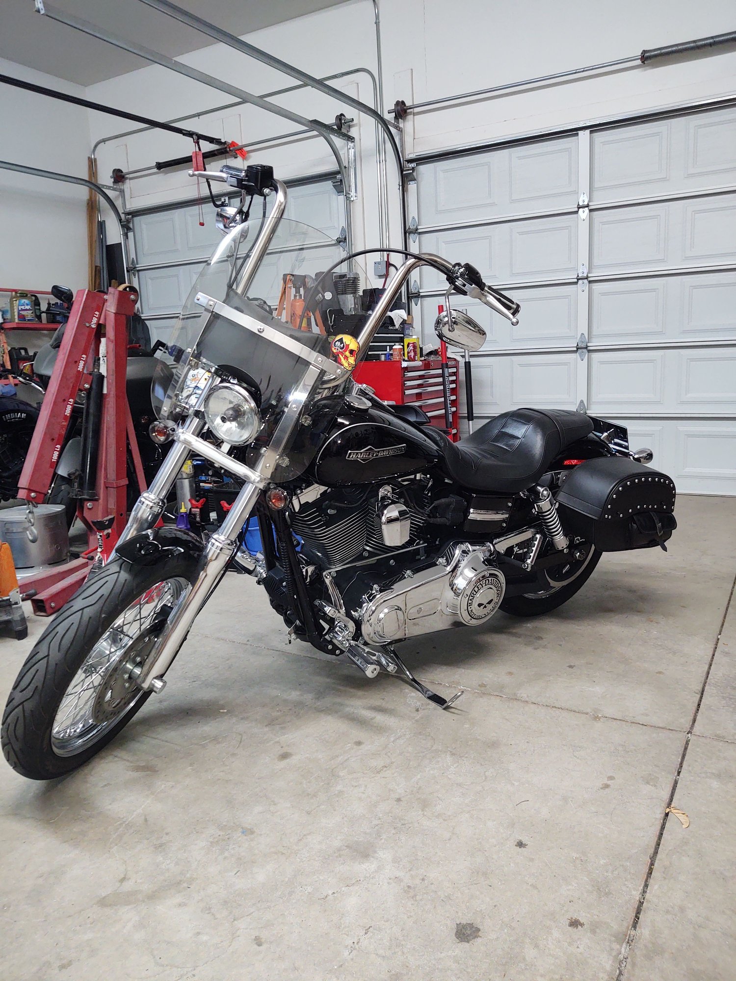

You will need cables, lines and wire extensions for anything over 12. Just did 16's with 34 width on my 2011 FXDC using the burly kit for 16" bars, everything worked out great. You will also want poly riser bushings, transmission oil, and a transmission cover gasket. Hope that helps.

Old Apr 25, 2021 | 08:03 PM
BUILT's Avatar
BUILT
Joined: Jan 2019
Posts: 47
Likes: 21
From: Saint George, Utah
Old Apr 25, 2021 | 10:49 PM

Gorgeous bike. Thank you for the info that helps tremendously. Have not found a guide online so the transmission oil and gasket helps a ton. What will that be for? Clutch cable I’m assuming?
