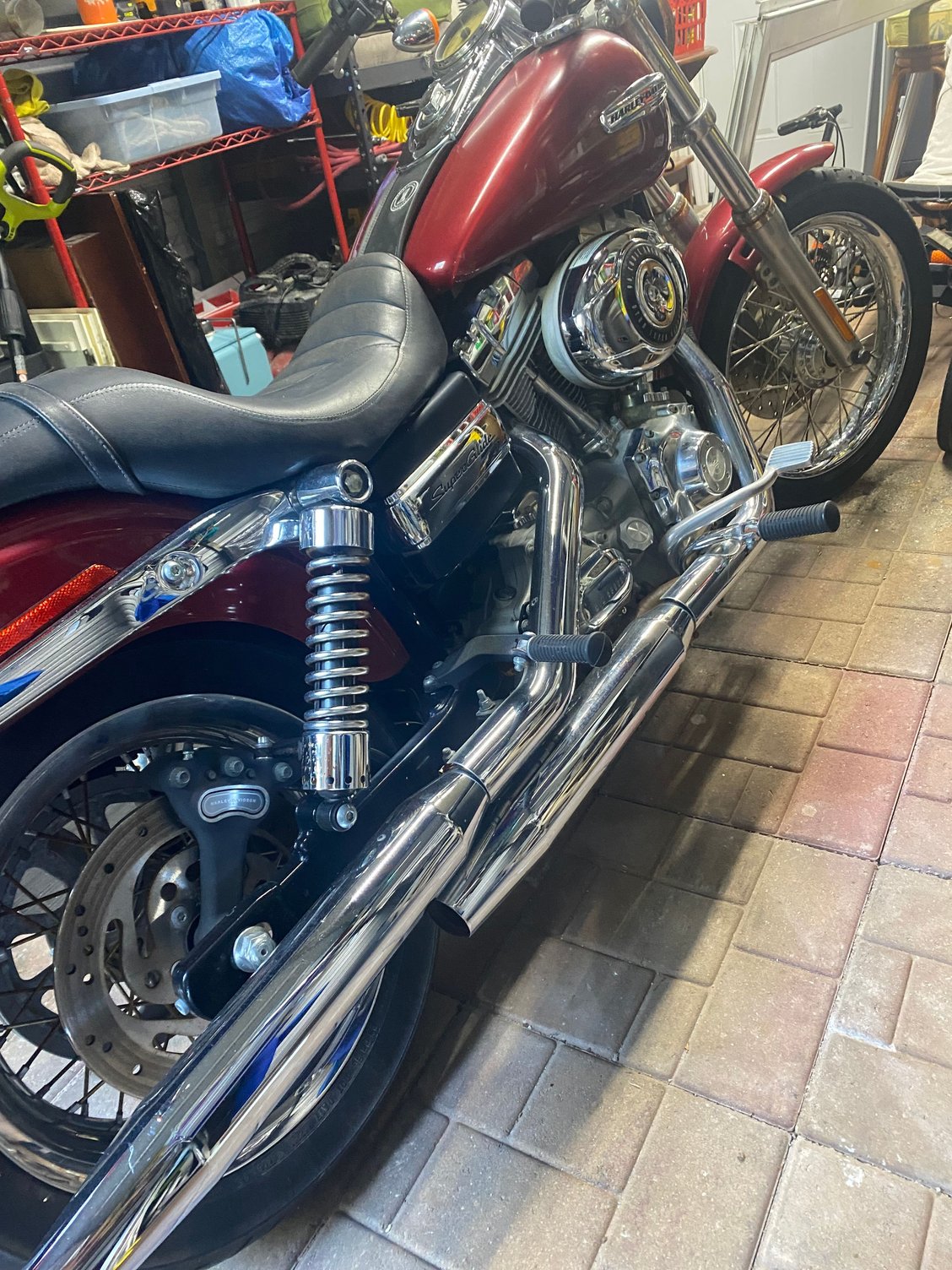

Hello, this bike has not been started since 2012, what would you recommend I do to fire it up? Plugs, clean gas tank……? The front brake doesn’t work, do you think the original battery can be charged any suggestions

A 9 year old battery is junk. Change all fluids, oil filter, flush gas tank, fill with fresh gas and add 3 oz of fuel injector cleaner to the gas. AFTER ya get it started, rebuild the master front & rear brake cylinders. Then replace both tires.
Basically what he's saying...I got an old Sportster a few years ago and the front disc brake system was full of putrefied fluid and internally corroded. Very clean, classic looking Superglide in the pic; appears to have not been disfigured in any way by the former owner. Lucky find

When you're ready to start it, put a little oil in the top of each cylinder,. Then crank it over with the plugs out until you have oil pressure, then put the plugs back in and try to start it.
