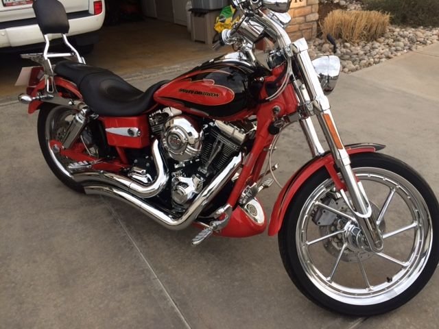

Originally Posted by SJMathisen
I have 2 CVO DYNA'S...never had any type of wobble. Remains one of my favorite platforms.
A red and a yellow .
Spanish colors.
Very nice. 👍
