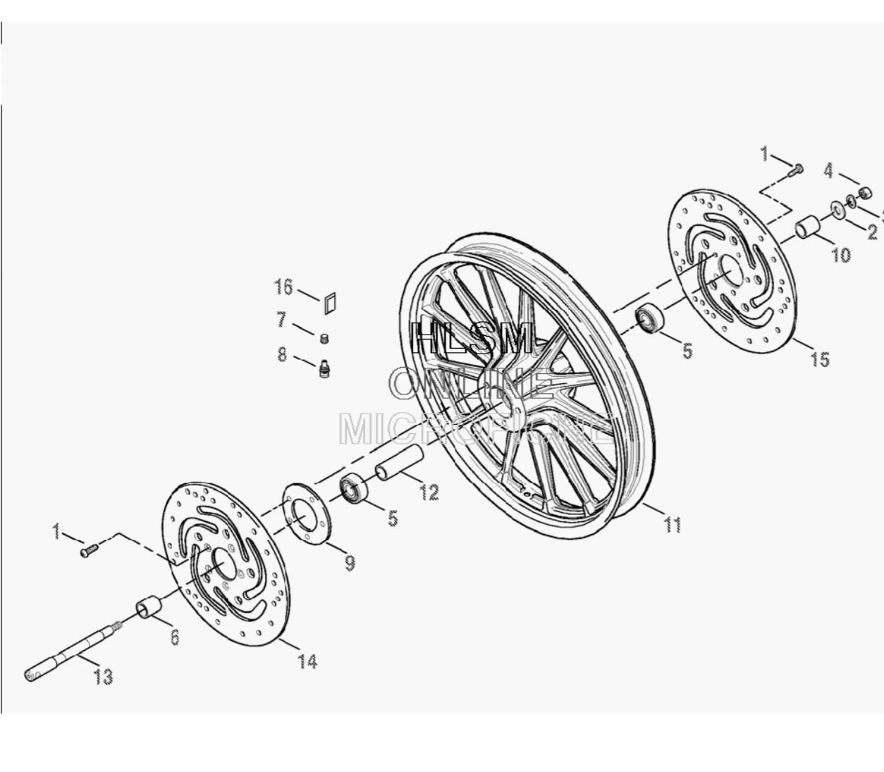

I changed my front tire yesterday. Looking from the front of the bike. I noticed only one wheel spacer on the right. In my manual it shows 2. One on the left and one on the right. I got the bike used with only 10,000 miles on it. Anniversary edition. Is this normal to have 1 spacer or should there be 2?

#10, and #6 are the spacers you should have.
that is the same exact drawing I seen in my book. I'll have to look for sure when I get home. If I don't find it do you recommend a place to get them or know the size. I'm a machinist so I could make one if i had to.

Originally Posted by Dukes37
And I only have one brake rotor. Does that make a difference?
No.
The drawing covers multiple models
Single and double disc both have 2 spacers
LH is 43617-00A
RH is 43358-00
Order from dealer
Might make a difference in size. I thought LowRiders had dual discs. As said, dealer or maybe a good Indy should have an assortment. ID and OD will be the same as the other side I would think. But the length I can't say.

When you look up his bike the pic shows both rotors but lists only one side as that`s how that model is equipped ( the rotors are "handed" and have different P/N`s)
When you look up LR Sport ( dual disc ) it`s same pic but both rotors are called out in description section ( LH & RH )
The spacers are the same P/N for both models
( it just saves separate drawings for the fiche creators )
