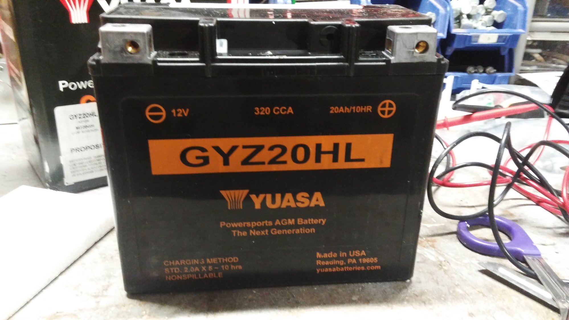

I don’t see the advantage of the lithiums over AGM other than lower weight, and lightening your wallet. Yes, they don’t self discharge…but they still are subjected to parasitic draw discharge. And they have lower Ah ratings than AGM. I recently installed the Yuasa 32 and am very happy with it. I only put it on the tender if I haven’t ridden for over 1 week..and it always starts strong.
