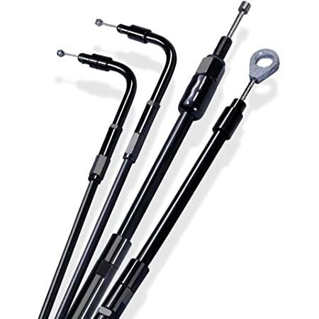

Here is a pic of the Barnett cables (2 cables on left). They are exactly the same on my bike. No modifications. Completely stock.
