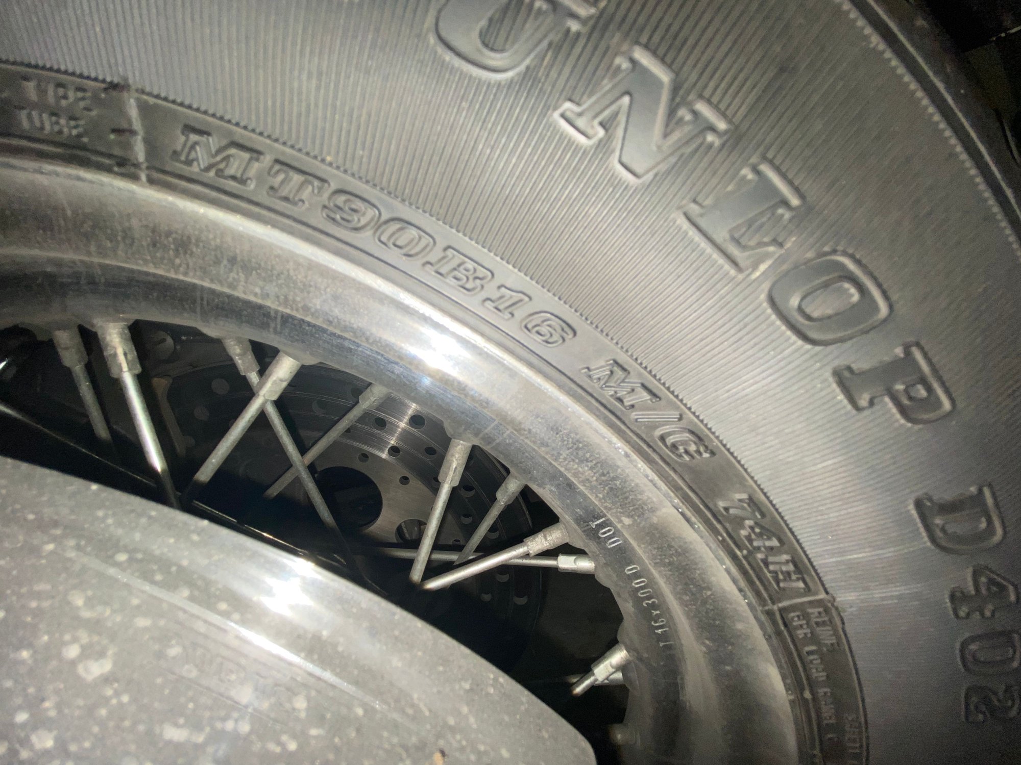

Pretty sure my rear wheel is 16x3” due to markings on the side. Can anyone confirm? Tire size is MT90B-16 74h, wheel says T 16 x 300 D on the side.

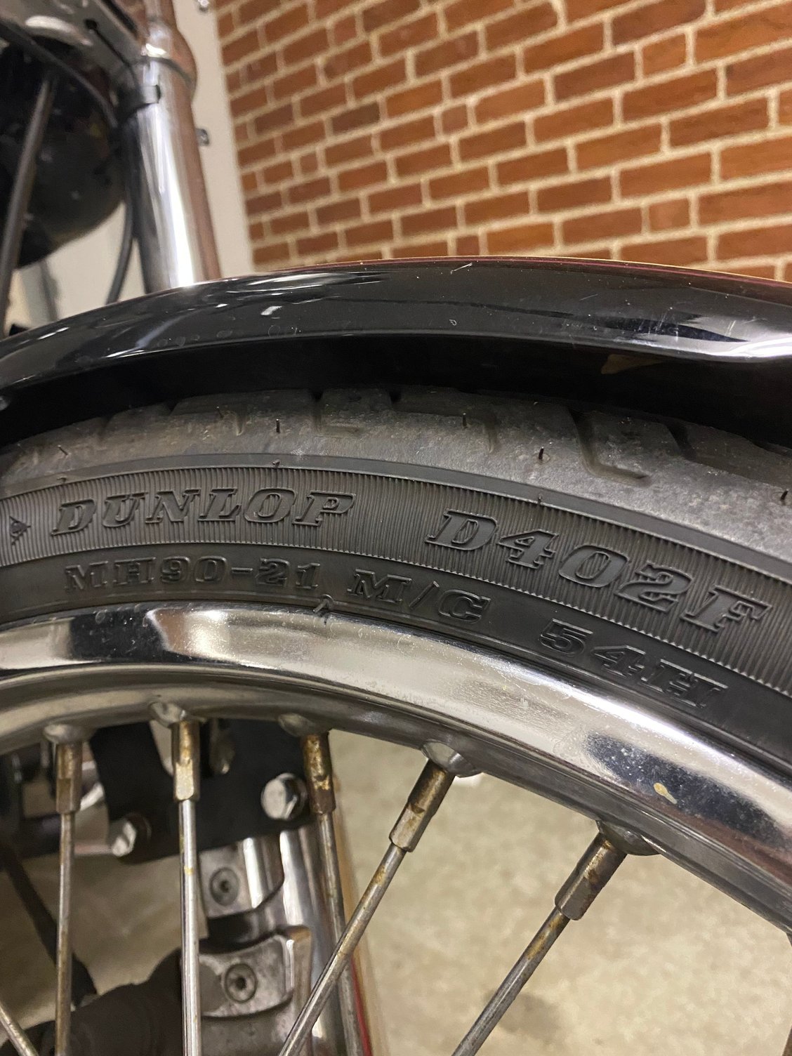

Not too sure about width on 21” front. No marking on wheel. Tire is MH90-21 54H. Pretty sure it is 21x2.15”
