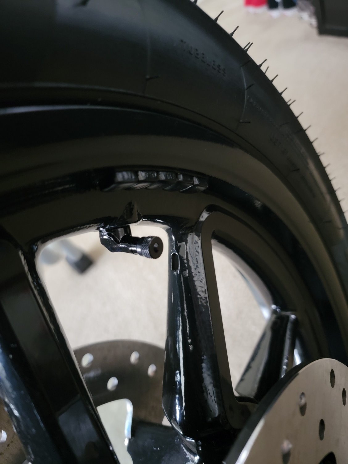

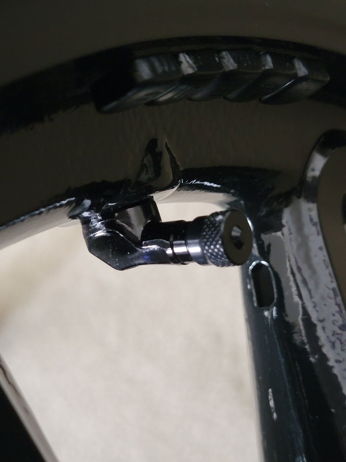

I thought I'd post pics since I finally got the KurveyGirl stems installed on the new rims. They are VERY well made, installed solid as a rock and as you can see, there is no way that they are going to "fail" or cause interference. They are solid aluminum bottom to top and are going to make pressure checks a lot easier.

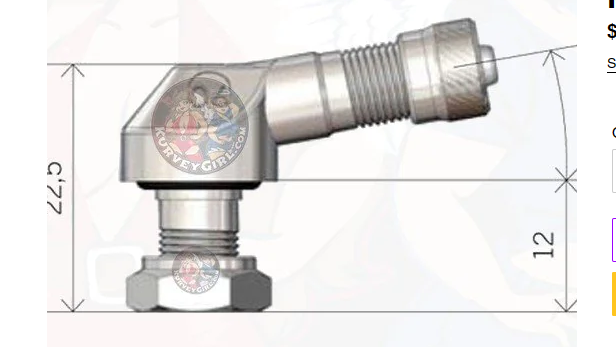

Hey snake eyes I just bought a set of Bridgeport valve stems for my low rider wheels. My wheels only have a spot face on the inside of the wheel not on the outside. It looks like the valve stem only has a rubber gasket where it touches the outer part of the wheel. Any verification on this ? Or is there a inner and outer gasket with the valve stems.

The KurveyGirl stems only had O-rings on the outside also. IIRC the nut had a flared base that flattened against the inside of the rim and they recommended blue Loctite.
Edit: Yes, that's right. here's the diagram from their website

Man I don't know what I was looking at earlier. My wheels do have a little boss on the outside for the valve stem. It's just not machined. Hopefully it still seals. Thank you for the reply.

Yeah, that's the same rim I am running. My are just powdered black.
