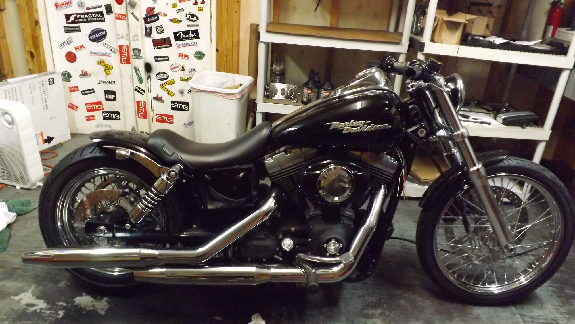

Here is a photo with them placed on the bike for the curious ones here:

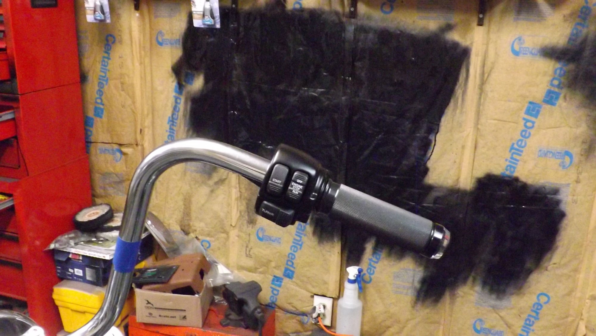

It looks like an eight inch shorter clutch cable will work. Magnum makes one.
It feels like this build your own throttle cable with the 65 degree bend instead of a 90 degree will be the best bet
With the flush mount fuel caps installed, there should be no clearance issue.
It will have custom dynamics bar end running/turn signal lights and these joker machine knurled open end grips.

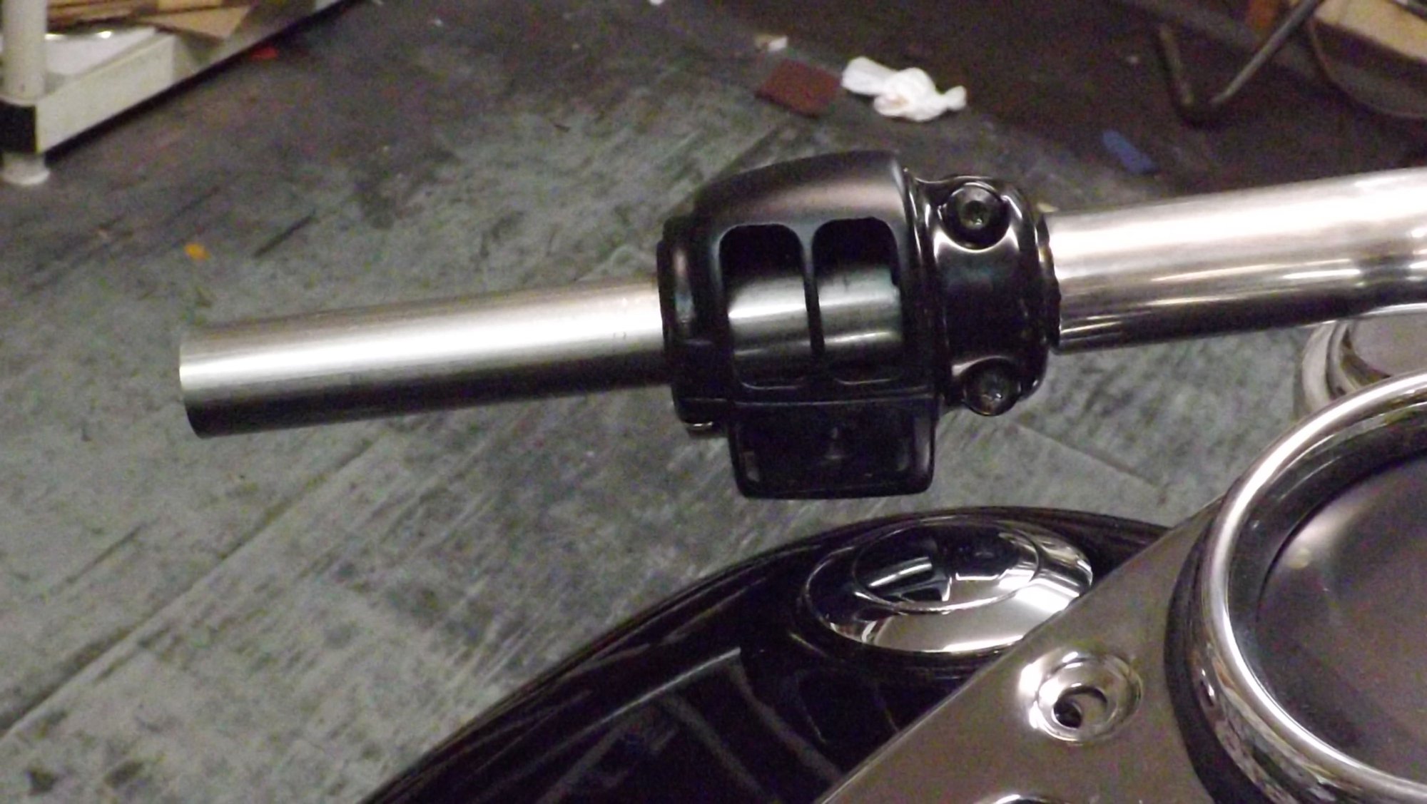

I tried the magnum build your own throttle cable with the 45 degree bend it does now work well, so I ordered the cable with the 90 degree bend.
Tacked on more parts, adjusted angles of things, sat on the bike to get a better idea how it all works, feels, and how it will look. I like it!

It has progressive 412 11" shocks on the rear, and the front has a progressive fork lowering kit installed where I just cut it down to taste- I estimate about 1 inch lower give or take.

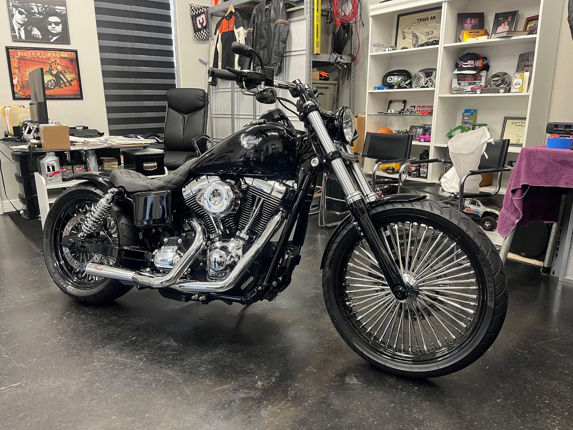

I have a similar build on my bike. Mine runs the Wide Glide set up for the bars, so mine have a riser from the triple tree to the bars. I had a custom front break cable made but the rest are wide glide cables on my Street Bob. I think I have a receipt with the part numbers if that would help you but without the risers my cables may still be to long.
