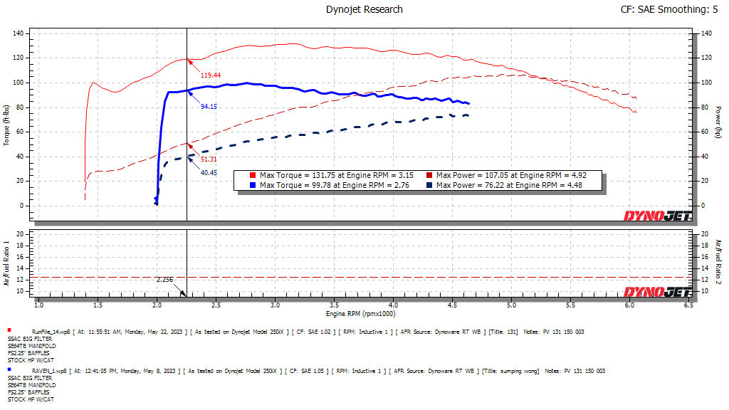

It can happen to anyone. Blue run is the second pull with a 131 kit in my trike. made less than stage 1!
Red run is after cut oring was replaced- now I can start tuning...

In case you are wondering where all that power goes, it goes into the motor.. 10 second run and 40 hp loss means you just dumped 30KW of heat into the motor for that run.. The oil is getting that power as heat and it's going everywhere..

Makes me wonder how much damage was done during a couple pulls- this combo is down on power about 15/15
