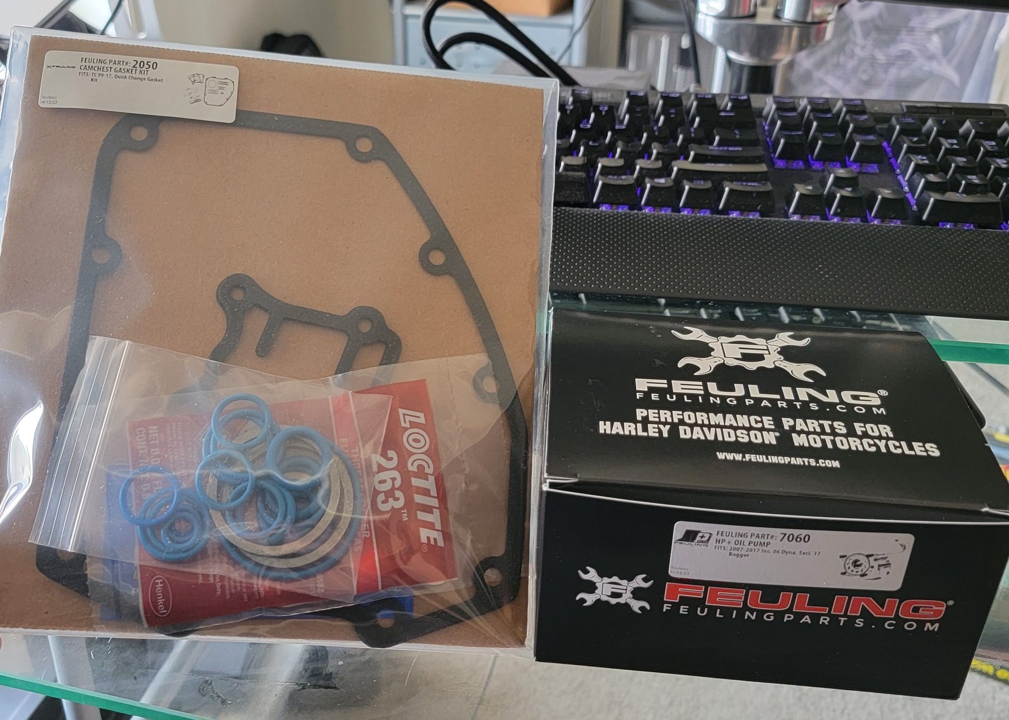

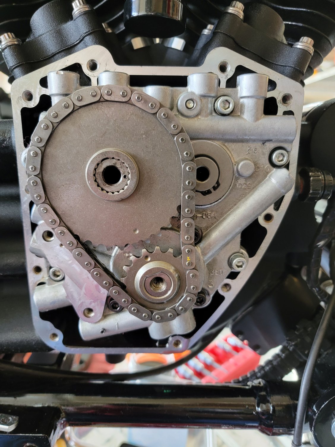

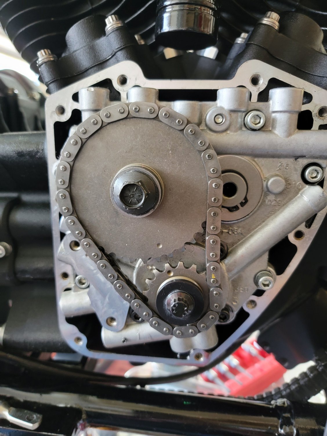

Brand new, Feuling HP+ oil pump cleaned. Lost one of the alignment pins on the shop floor for a 1/2 hour...that was awesome

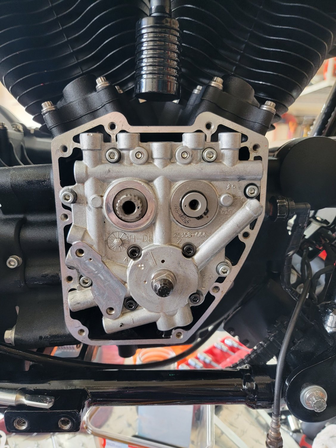

Lubed and assembled to the cam plate

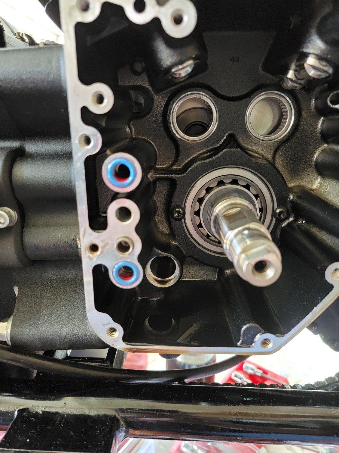

Big, fat, black, CORRECT O-ring installed
Pretty blue Feuling O-rings installed
Incrementally tightened and torqued (cam plate first) while incrementally rotating crank to center oil pump. Cams aligned

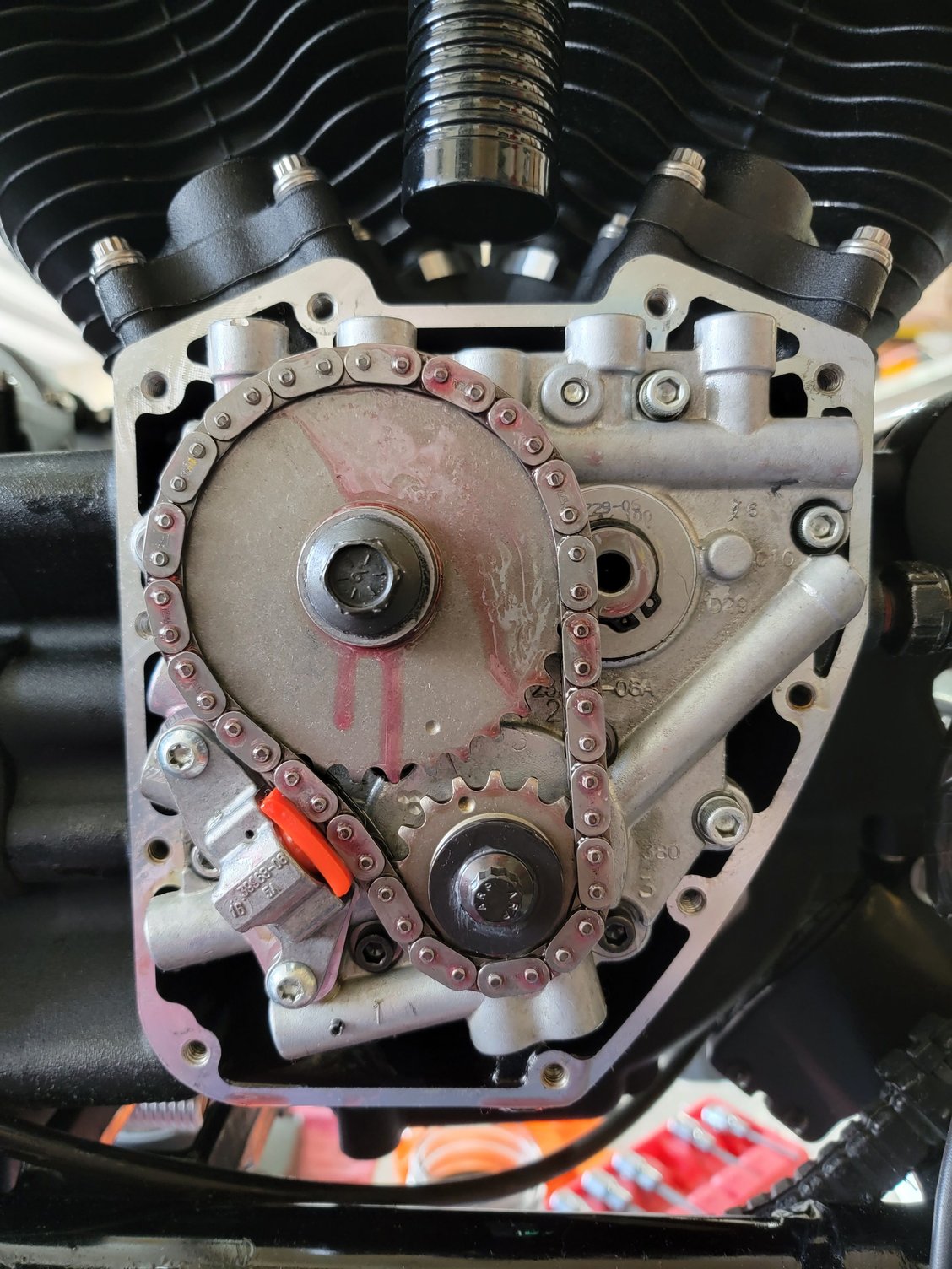

Measurements verified and sprockets installed, crank aligned to rear cam
Cam and crank bolts installed and torqued
Tensioner installed and all torque rechecked after 15 minute rest
Thoughts while having a beer and looking at the finished result? I wish I had bought a Feuling cam plate. fvck
Pushrods tomorrow and hopefully a shake down also. Ride with the wife on Sat for the 20th anniversary of our 1st date.

Looks like a better assembly...

What a process to figure it all out and intersting to learn that a little O-ring can make such a significant issue. Kudos to the members here helping out and picking up on it from that fuzzy pic. Looking forward to hearing about the end results after it's all buttoned up.

THAT. WAS. THE. FIX!!!
Finished everything up this morning and took it out for a shake down and it RIPS!!! Aggressive start and it lifts on 1st, 2nd, and 3rd!
Took it out with the wife (her on her '22 FXBBS) for about a hundred miles today. Beautiful weather and the bike is finally feeling dialed in. With the suspension tuning, cast rims, chain drive and the cam it's pretty perfect right now. Lots of power and the bike just wants to go! Bonus, no leaks or weeping anywhere AND the dreaded Thunderheader install went the best it ever has. The tip I got about setting the front header first, then swinging it up and into the rear is a life saver and it actually bolts up the way it should!
I don't have a new filter laying around so the oil change will have to wait till this coming week and then I plan on doing some auto-tune on top of FuelMoto's work. Maybe I'll even take it back for another dyno pull? Very much looking forward to it!
Thanks very much again to @Max Headflow and his keen eye for spotting that O-ring!
