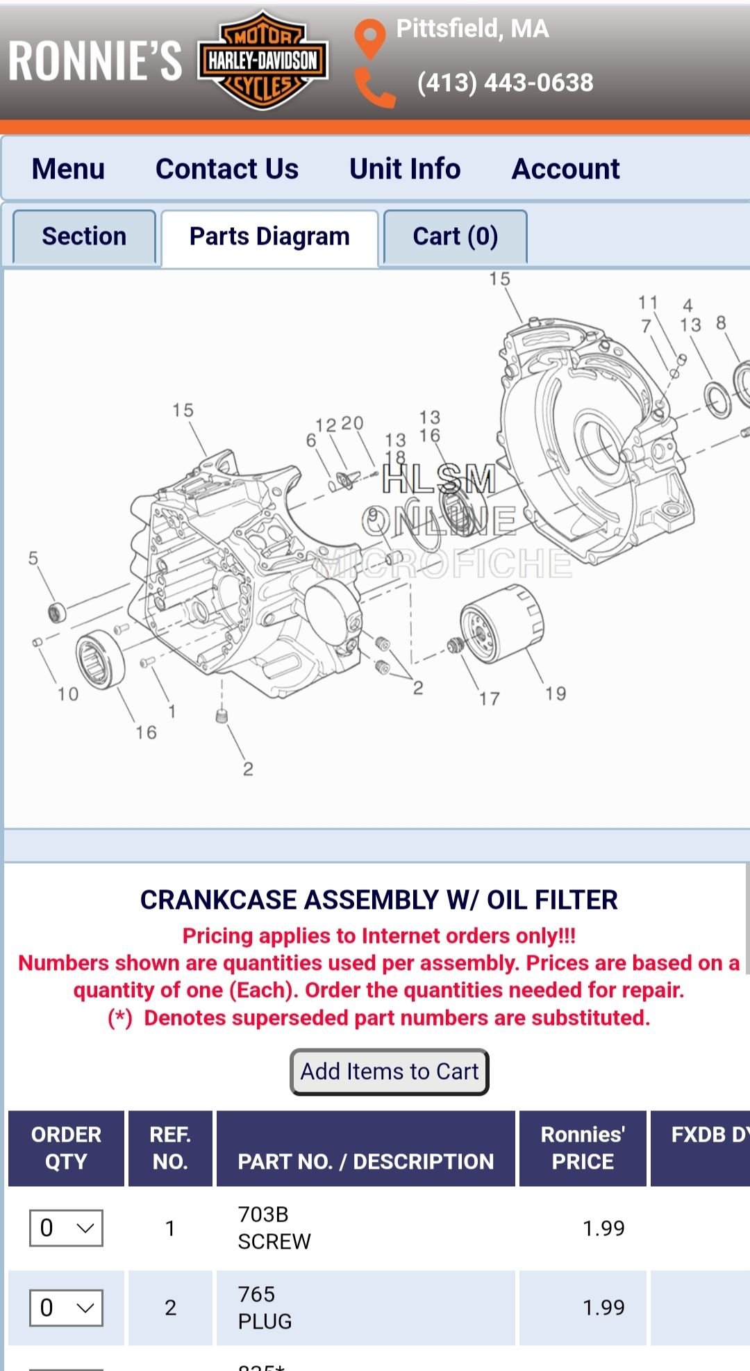

It's not a drain plug, it's a passage plug.. I've yet to remove one...
I have been told that it is a drain plug and I even pulled mine once and out came 5oz of oil.. Which I was also told was ok..5oz ain't that much to be considered for sumping. See #2 in the following pic.. When you install the pipe fitting plug use for with PTFE and don't over tighten, it's a tapered plug..

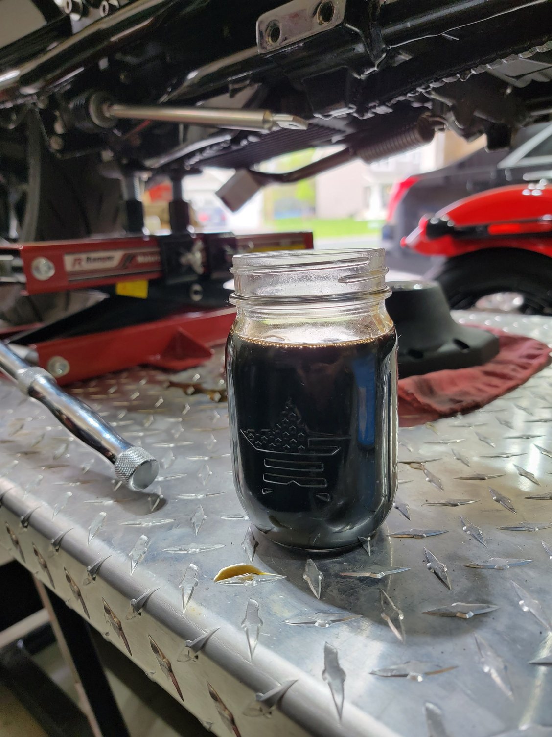

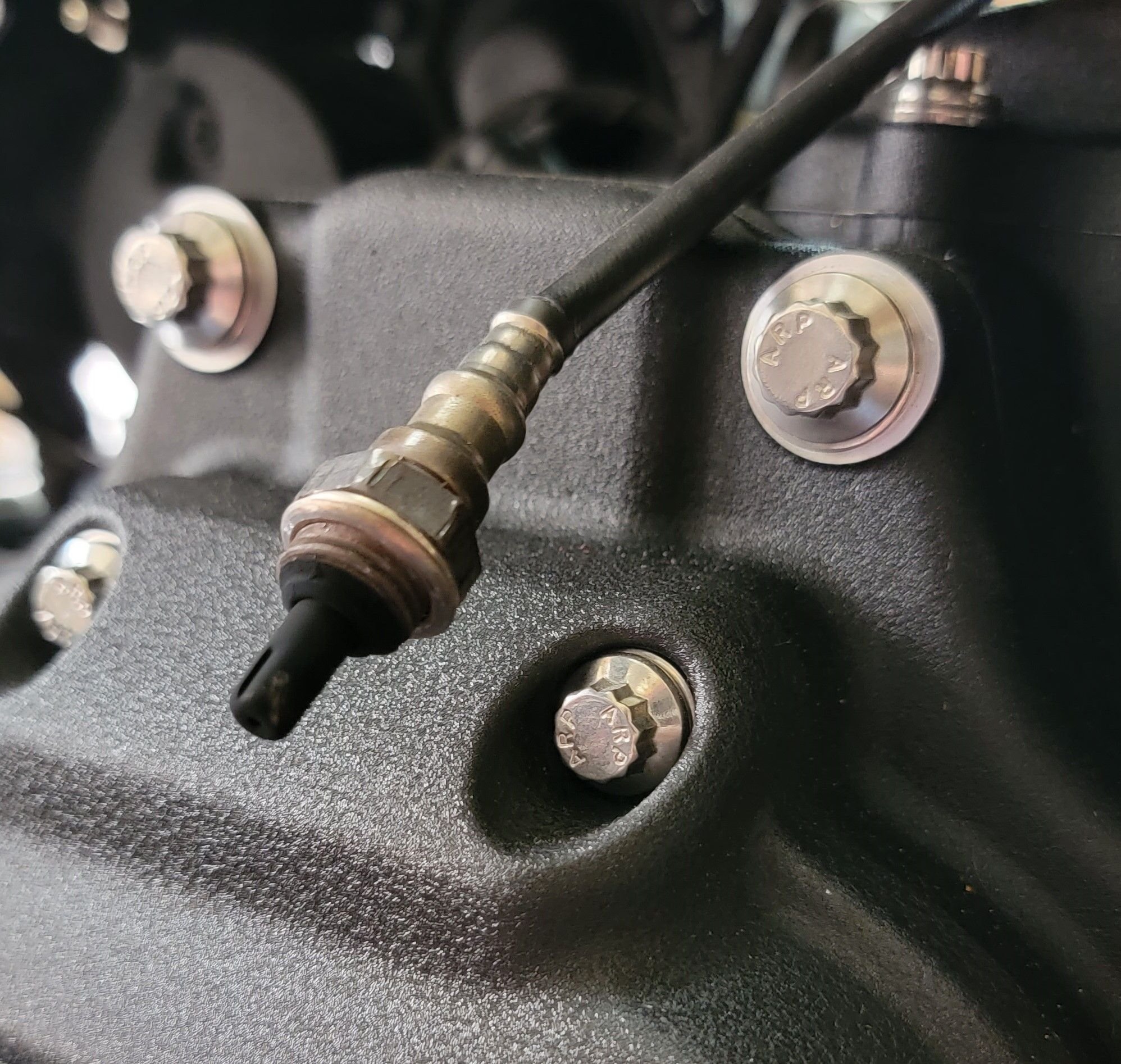

Started tear down, don't have the cam plate out yet. Here's what I know for sure:
There was over 14oz of shitty looking oil in the cam chest (seems like a lot?) and the O2 sensors really don't like what's going on upstream.

With that much in the cam chest, there is more in the crankcase.. Motor is definitely sumping..
