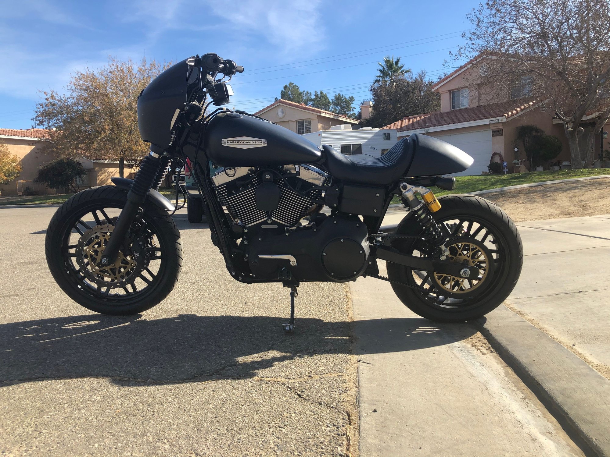

Was wondering if any one could answer a few questions I have for my particular situation. I searched the forum a bit and couldn’t find an answer. I’m attempting to install a chain conversion on my 07 fxdb and while test fitting the sprockets and chain realized I have some interference with the inner primary most aft mounting bolt boss and chain. Also looks like the chain will rub at the upper front of the swing arm. I realize when I set the bike down off of the stand and with rider weight the angles will change some but I have close to 14” shocks and a 1” shock lift spacer and eyeballing all this doesn’t look like it will clear. I’ve read that people with 13.5” shocks just clears and the chain rub from bung king takes care of the possible contact with the swing arm. Any one set up like me and successfully worked around the primary contact issue? I don’t mind doing a lil trimming here and there as long as safety isn’t compromised. Any insight would be appreciated.

I have the 25/54 combo. I needed the extra height to give me clearance for my tail modification. I cut my struts and built a custom mount for a cafe style rear fender. Under certain compression situations like from a nasty rut or something it would rub. I also wanted a lil forward rake for looks. I have ohlins cartridges in stock height tubes.
Sweet looking bike!
That thing is sweet! I would think with a 25/54 you wold be ok but apparently not. Mine is +2 up front and 14's in the rear. i was on a 24/55 combo using the bungking slider and had no contact anywhere but the slider. I swapped out my 55t for a 53t but haven't run it yet. Wish I had better insight for you.
