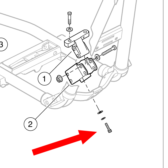

Hi guys!
What is the measure of front isolator screw (2 pieces) which hold front engine mount - isolator to the frame??? Are those 3/8 UNC thread??
I'm gonna experiment a bit with shimming my front engine mount isolator as well as to shave a bit of upper rubber parts, to see if I can get some improvements on engine vibrations. For that, I need to order longer isolator screws, but I'm a bit unfamiliar with imperial screws, so a bit of help could be useful

According to my 2003 Dyna P/N they are 3/8-16 x 1-1/8 inch, grade 8 bolts.

Thats what I thought. Will order the same but longer. Thanks!
