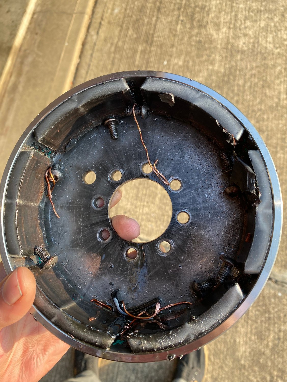

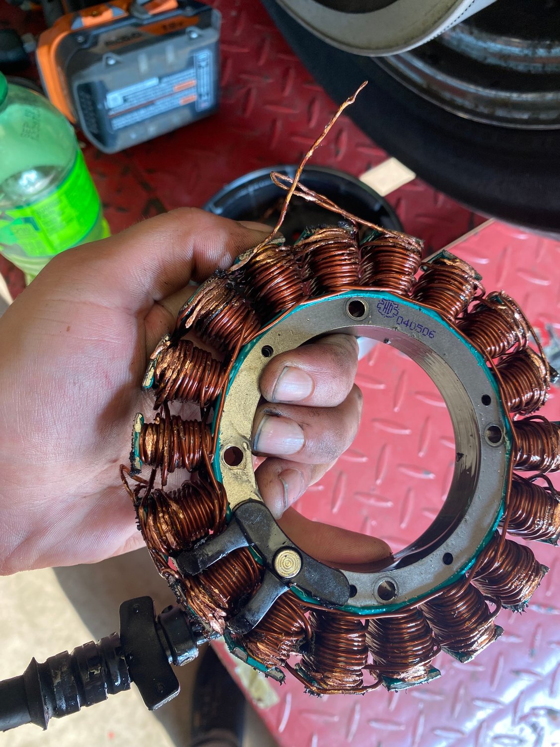

Here it is sorry took so long. The two piece rotor had all the bolts pulled out and they destroyed the stator.
which has happened to nearly everyone I talked to with an 06 dyna. Glad they changed to the one piece finally. Way of admitting it was a design flaw without actually them taking responsibility.

That thing is tore up
Amazed you got some good readings Dang
Ok Glad ya got it going your way
WP
Yeah, I can't see how that could be possible. Broken wires don't give good resistance readings.

right it made no sense to me either.

With the wires ground up like that, they could be shorted together.. I don't think it would have past the isolation to ground test tho..
