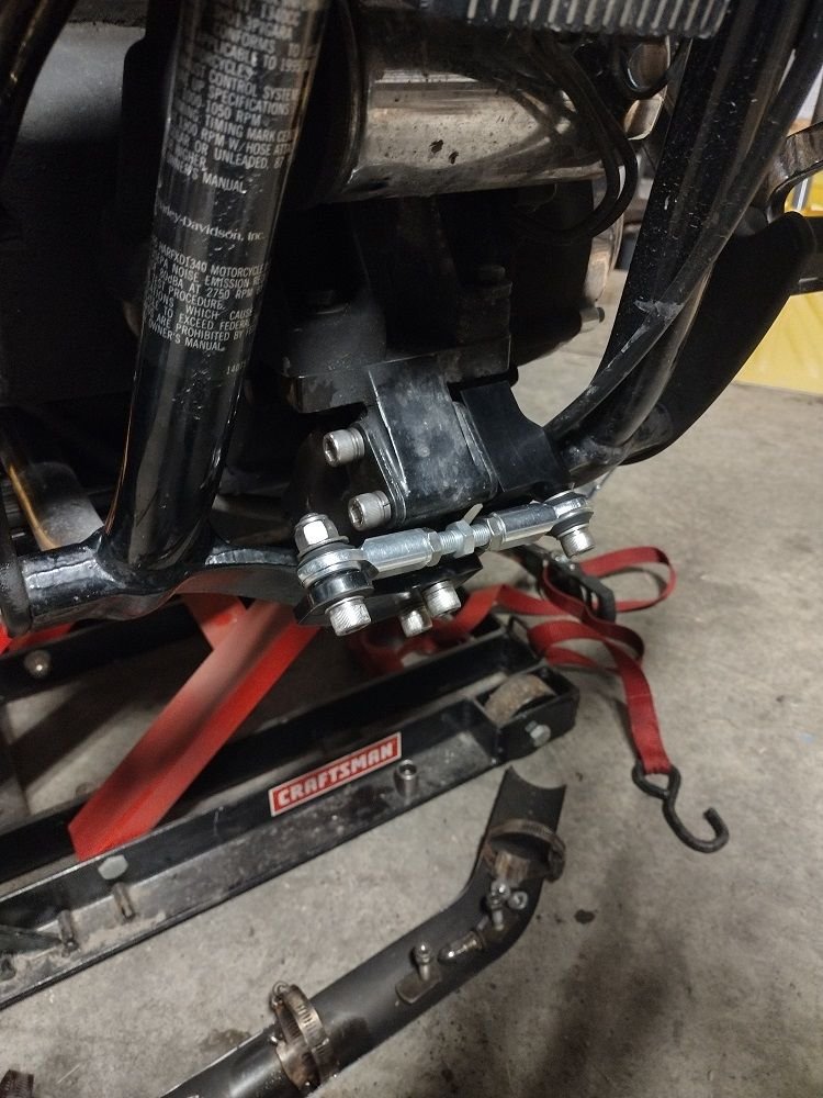

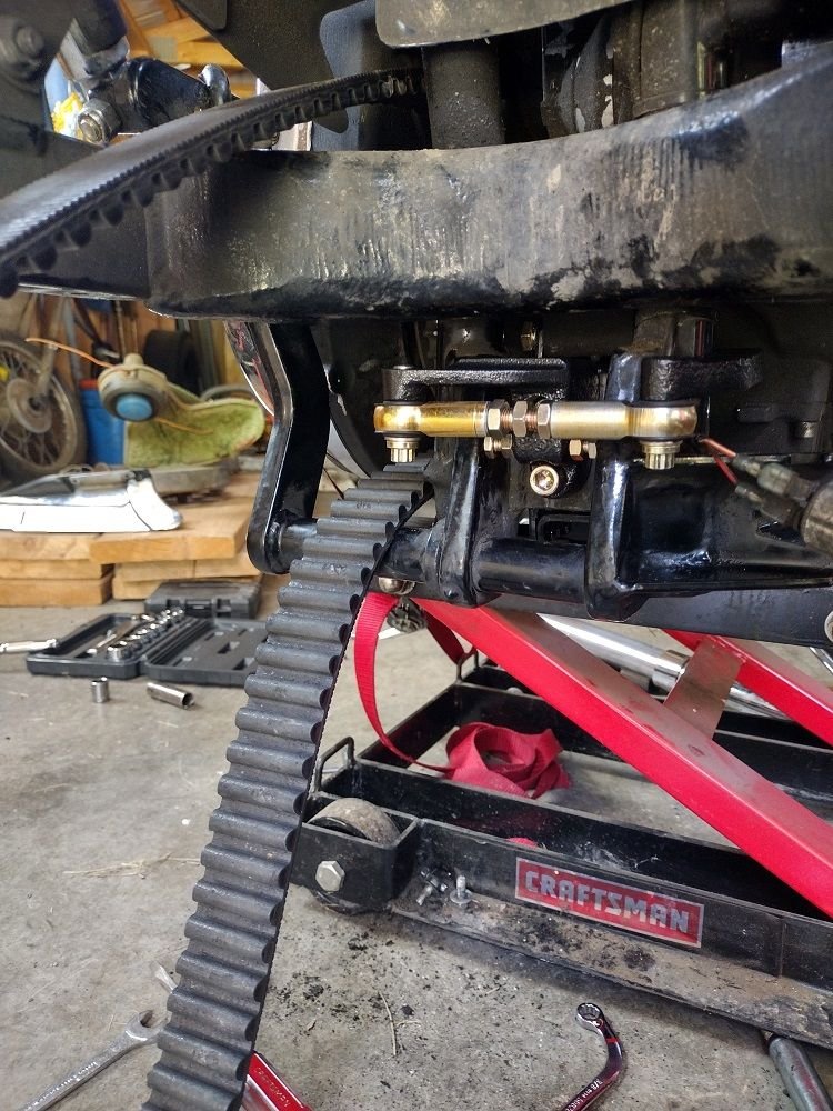

1. New (Harley Davidson) Motor Mounts
2. Sputhe Front and Rear

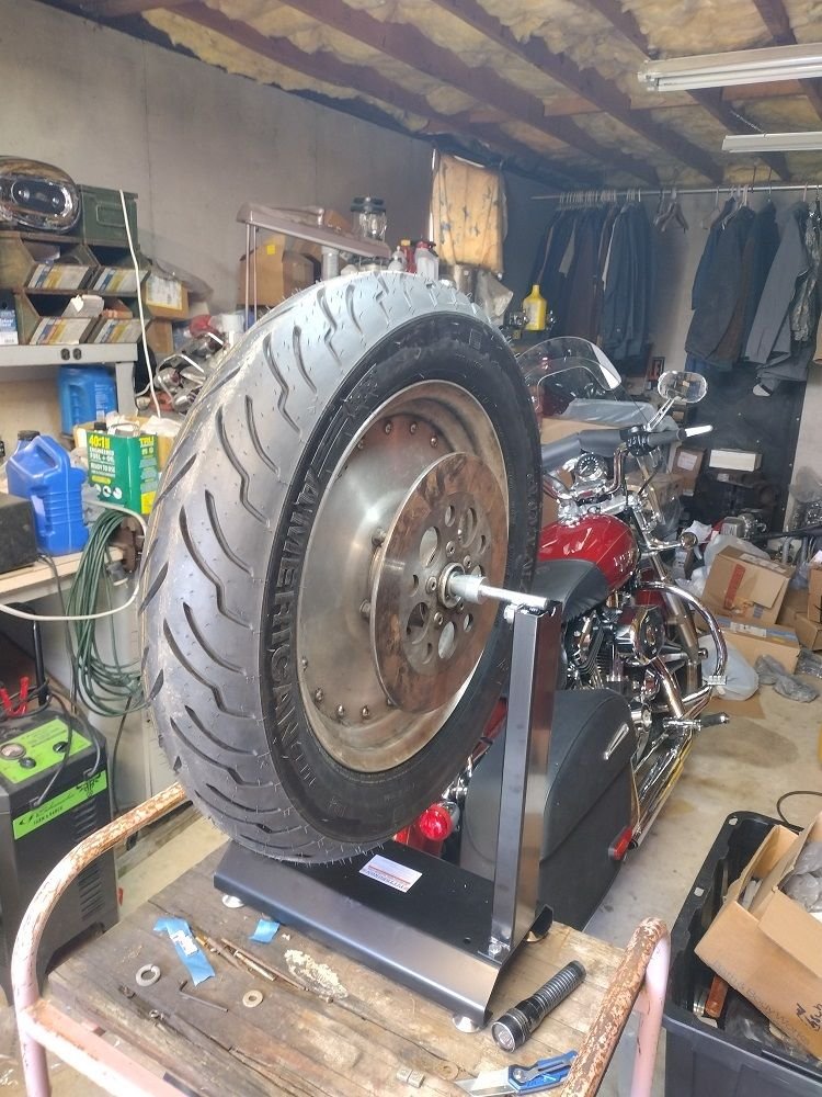

3. New MU85E16 American Elite Rear Tire.

What a MAJOR difference. The low speed (parking lot) handling is where I notice a BIGGEST difference. At high speed there is NO MORE unexpected lane shifting, wandering or wobbling. I never noticed how bad it was but the handling sucked REALLY, REALLY, REALLY BAD. I am amazed in the difference. Next I am planning a Race Brace the tie the engine and transmission together.

The Sputhe rear brace contriols lateral flex between the tranny and the frame. The swingarm mount is still another place that the system can flex.
