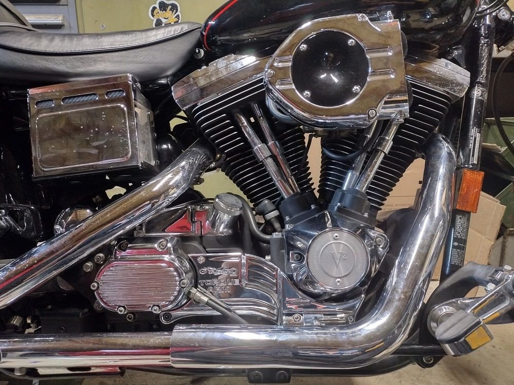

Fixed now. Yesterday evening I loosened fork brace again. I went further and loosened the bottom triple tree tube pinch bolts and fender bolt. Knocked the front tire on a pole again. Tightened everything back up went for a test ride. 50% better. When I got back from the test ride I took the windshield off. I loosened the handlebar riser nuts and straightened the handlebar.
This afternoon with the handlebars straightened I went for a test ride. About 75% better so I figured I was heading in the right direction. When I got back to my shop still with the windshield off I loosened the top triple tree fork tube nuts. The bottom triple tree tube pinch bolts, fender bolt, fork brace and front wheel. Knocked the tire around on the pole again. Tightened everything back up, went for a test ride and the bike tracks straight and true as an arrow. It rolls (glides) easier and it feels right. I am very please with the progress and happy with the end results of my work. The DAYN WOBBLE FIX. Well worth the expense and effort. The Wide Glide is a different motorcycle now. I can now ride it with total confidence...

I used to get headshakes accelerating out of corners before installing Sputhe kit front and rear. Headshakes are gone, but now bike shakes more while idling.

Did you replace the motor mounts when you installed the Sputhe Stabilizers?
Edit: Further chassis modifications. Last night I added a Carlini Torque Arm. I haven't had a chance to test ride yet but I suspect it can't hurt.

Test ride this afternoon after installing the Torque Arm.
All I can say after everything is the transformation in the bike is AMAZING.
