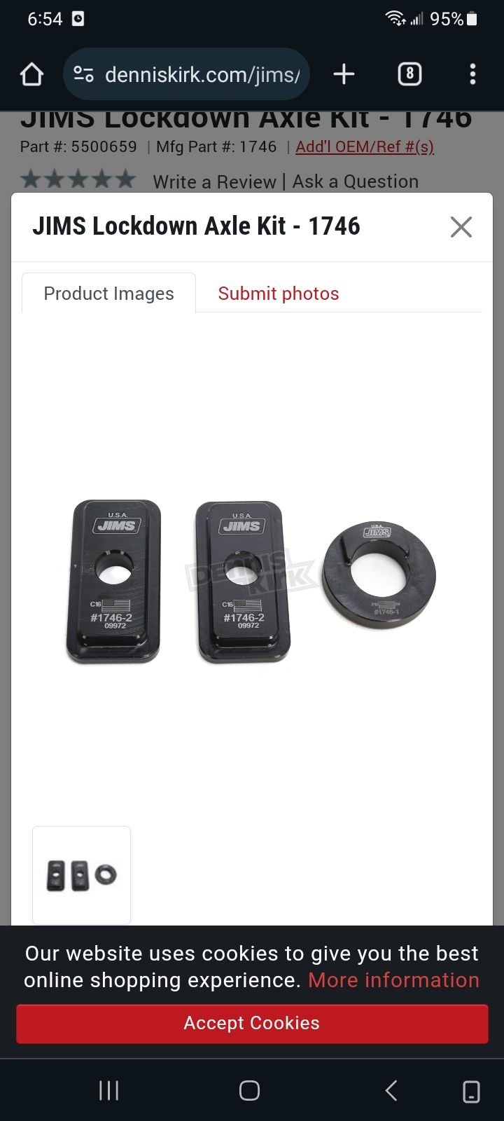

Just wondering if anyone has one of these kits. This would be for a 2000 FXD (Jims #1746). I can't find any retailers with stock so I was considering having a local machine shop make something up. If you have one of these I'm curious about certain dimensions.

The lockdown washer looks more like a gimmick than anything. Unless you're building a drag bike, IMHO the stock crown nut works just fine.

Thanks for the link! I see that TCBros makes something similar. The thing I don't like about the stock, flat washer under the castle nut is how concave it ends up. As that washer flexes and changes shape the axle nut torque loosens.

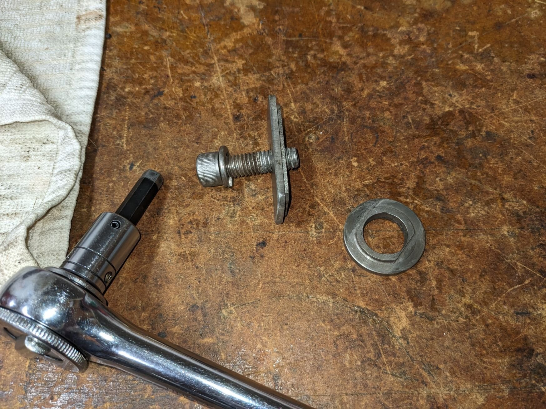

The plates are 1"x2" with say a 0.080 step on the inside. 3/16 to 1/4 inch thick. The swing arm is standard 1 x 2 box tube. Probably 1018..
The washer is probably 1/8 inch thick. OD maybe 1 1/8 to 1 1/4 with say a 0.760-0.780 hole in the middle. The protrusion is about 0.062 thick.
I made a set of stainless steel ones about 12 years ago.
