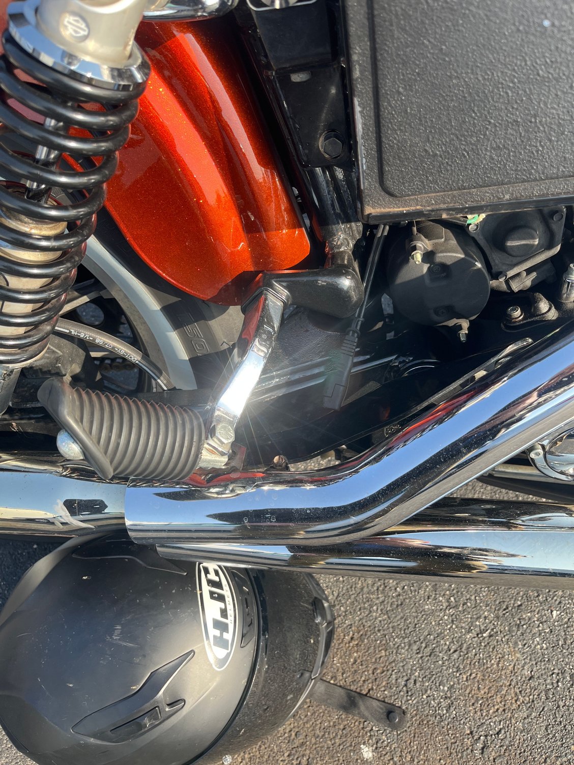

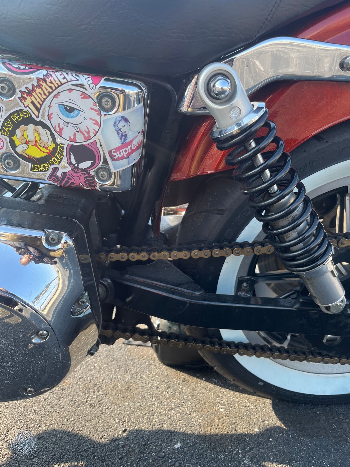

I have a 1999 dyna superglide convertible I am seeking a passenger pillion/mont for the primary side I can’t find one anywhere can anyone post a picture of how they look/mount I’ve looked everywhere and don’t seem to find a mounting point I have the exhaust side but not primary and help greatly appreciated!!!! Pics will be attached
Primary side missing pillion/post
Exhaust side

For clarity's sake, a pillion is a seat. You're looking for peg mounts.

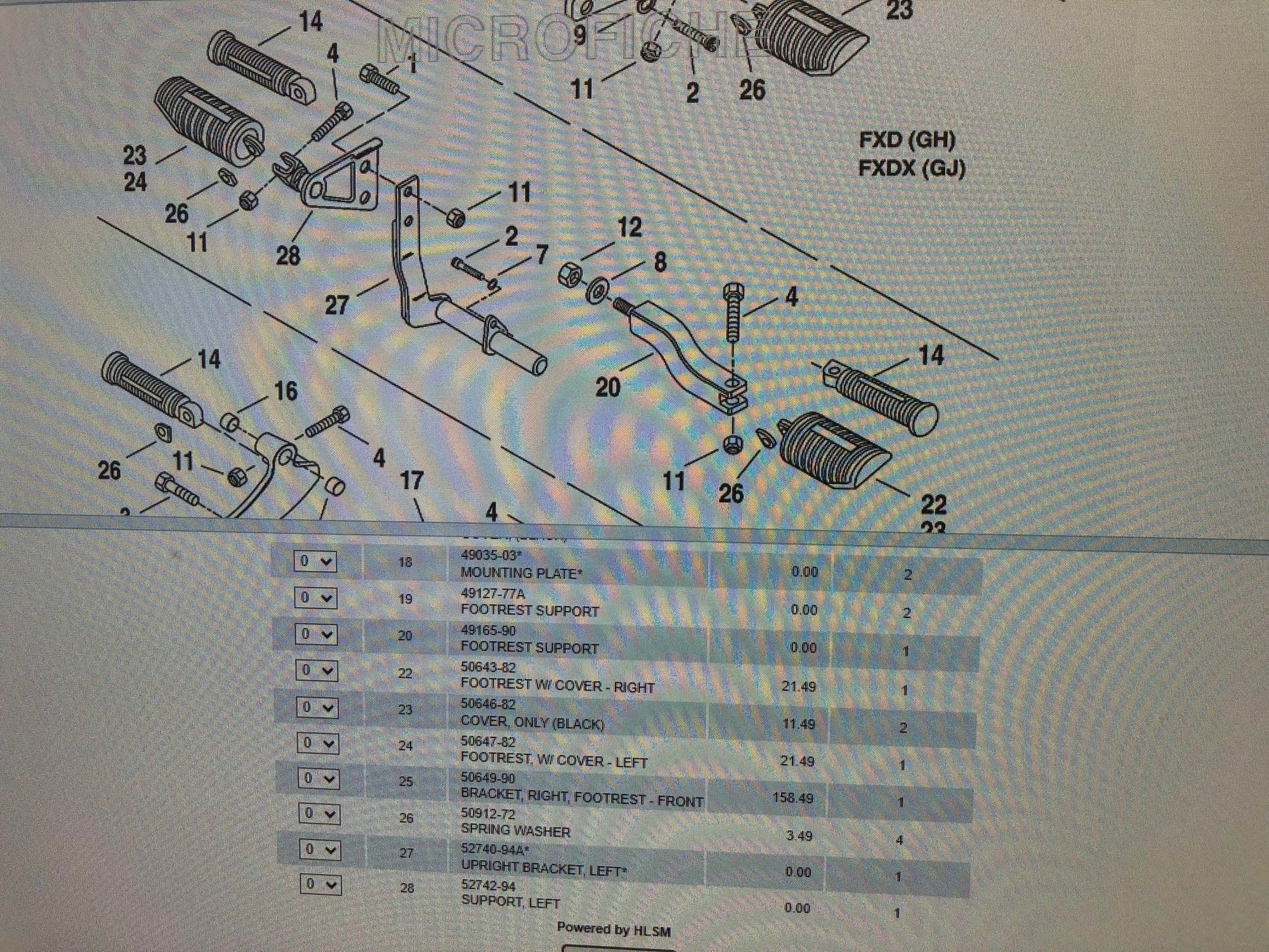

Here you go:
Ronnie''s Harley-Davidson''s Harley Davidson (onlinemicrofiche.com)

The (2) parts

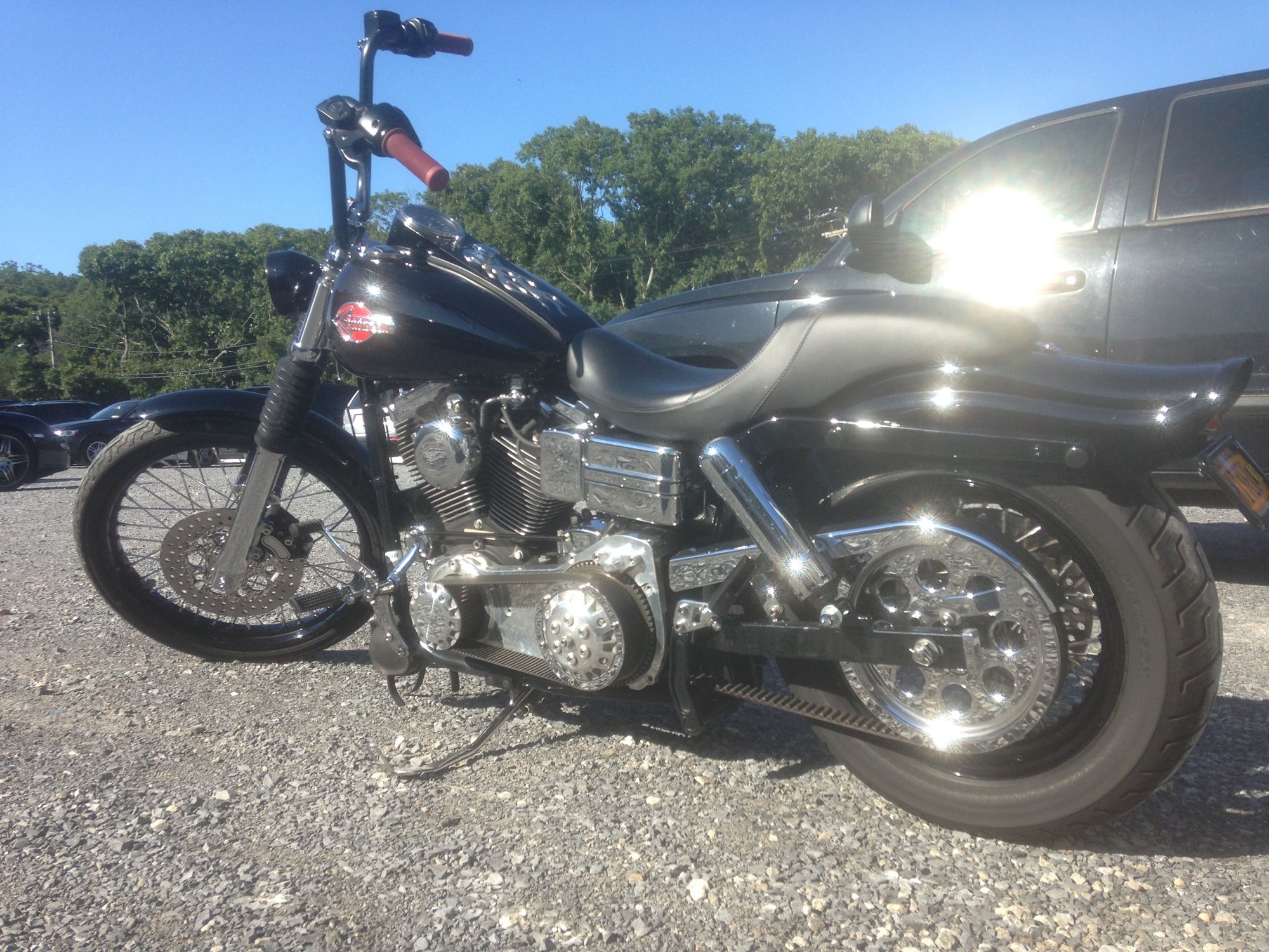

This is my 1997, you need the black bracket coming from the frame then the chrome one that holds the peg. Not chrome stock, but you get the idea, zoom into the picture. #27 and #28 from the diagram above plus all the hardware.
