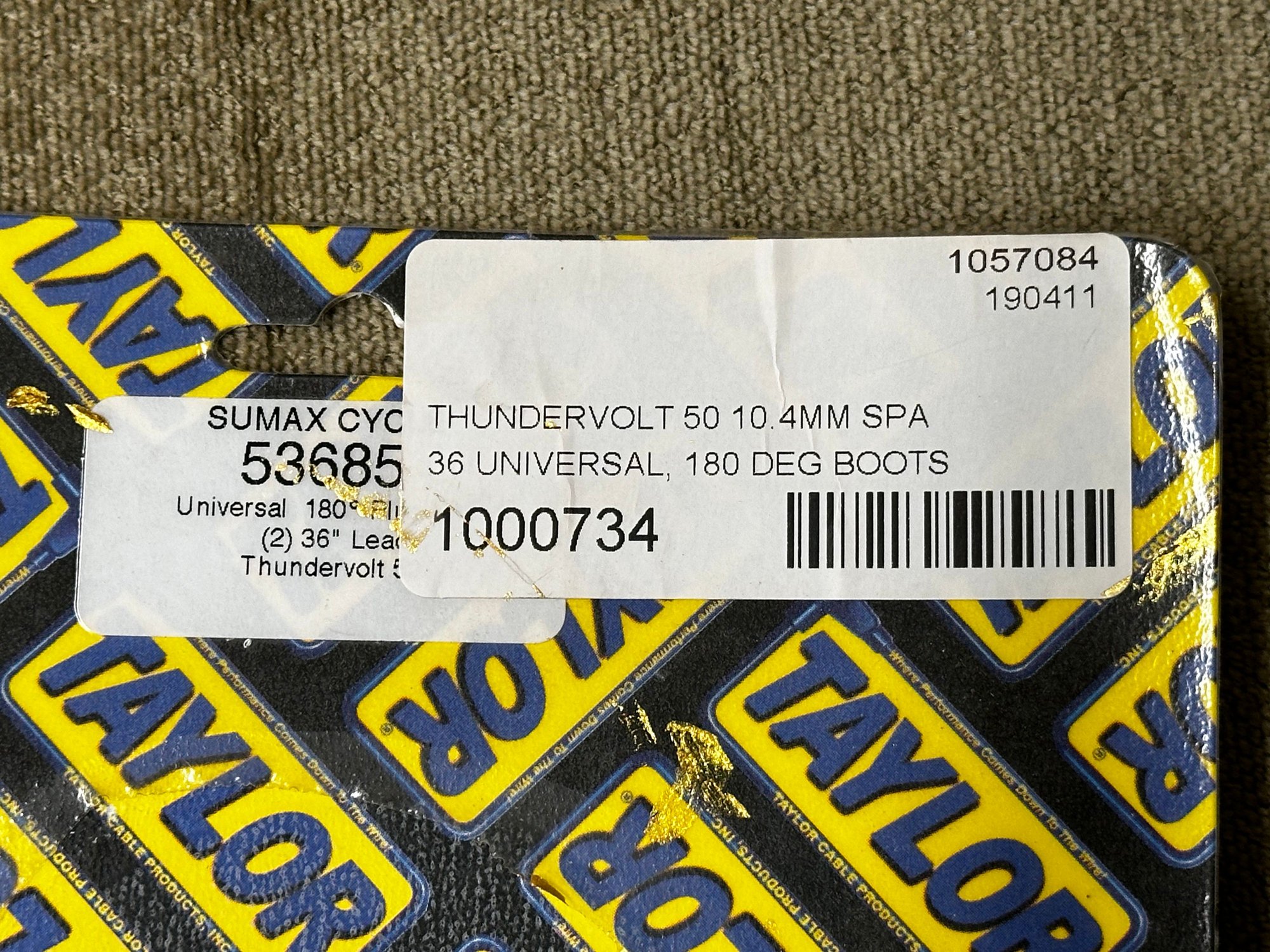

I would definitely just run the OEM wires, SE version if you want them a different color but OEM are gonna serve you just fine.
Full disclosure, I have my OEM coil in the pocket under the seat so had to cut wires to the length I needed, and had to solder an extension of the power wires leading to the coil.
My spark plug wires go up under the tank and then back to under the seat so both are longer than stock with the front wire being probably every bit of over 20-22", should have wrote it down but I didn't. Never any codes and runs as if it doesn't know the difference. Used these big fat wires.....
